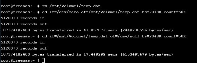

Some dd testing with both pools looks like the following:
Writes
dd if=/dev/zero of=/mnt/VMs/temp.dat bs=2048k count=50k
51200+0 records in
51200+0 records out
107374182400 bytes transferred in 40.536689 secs (2,648,814,795 bytes/sec)
dd if=/dev/zero of=/mnt/Data/temp.dat bs=2048k count=50k
51200+0 records in
51200+0 records out
107374182400 bytes transferred in 41.088641 secs (2,613,232,776 bytes/sec)
Reads
dd if=/mnt/VMs/temp.dat of=/dev/null bs=2048k count=50k
51200+0 records in
51200+0 records out
107374182400 bytes transferred in 14.702960 secs (7,302,895,867 bytes/sec)
dd if=/mnt/Data/temp.dat of=/dev/null bs=2048k count=50k
51200+0 records in
51200+0 records out
107374182400 bytes transferred in 14.915569 secs (7,198,798,782 bytes/sec)

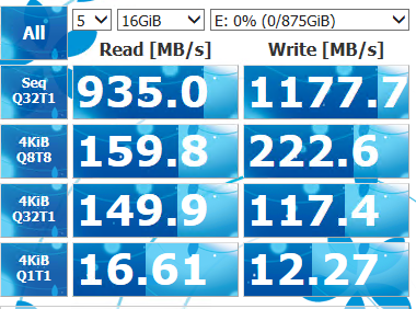

As for actual performance the NAS is delivering excellent iSCSI speeds so far with no tuning thus far via the SSD mirror pool. The following quick test was done on my existing Hyper-V server. I am also able to maintain nearly identical results even while copying data through a separate network interface via SMB at around 300~400MBs.
I think at the moment I will continue checking what can improve my speeds and start planning on getting a few more 4TB drives and another 2x more SSDs to add onto the pools.

Gotta be careful using DD and the like for performance numbers it has to be writing stuff big enough to really tax it, I have 64GB RAM and it's pretty much a hodgepodge of disks behind it and I essentially get the same numbers. I do have a 60GB ZIL and two mirrored VDEVS with regular hard drives on this pool.
I am sure it is fast though, but you could be getting a lot of that based on caching in RAM for DD, the ISCSI numbers are probably a lot more accurate though I would think.
