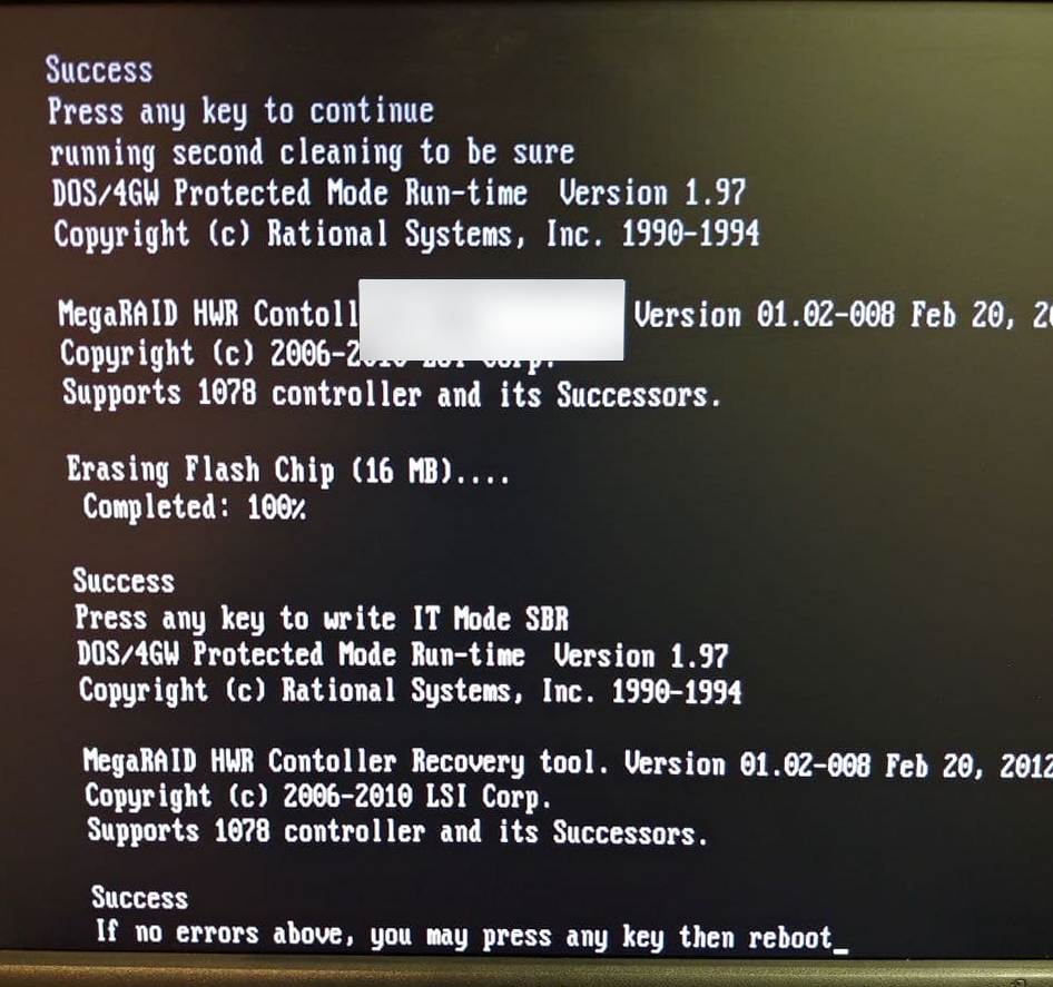

Well, there are plenty of posts on the problem but the solutions are all over the place so I cannot just jump at one and try it without knowing if it will work or cause further issues. Until I solve this, I cannot continue. Back to searching unless someone here know what I need to do next.
Steps taken;
Used the DOS disk first. Seemed to work ok. Rebooted using the Linux disk and did the rest over ssh.

Success!
I found this post after hours of searching;
The suggestion is to disable virtualization and a couple of other things. On my system, only virtualization was enabled so I disabled that and was able to update the card.
Because of the amount of time I had to spend finding the info, I figure I should share it here.
Ok, so, tomorrow, I'll re-install using the suggested methods. Once I better understand this, I'll also change my other systems since they would be wrong also.
root@debian:~#
Using username "user".

Disabling virtualization is literally the first step in my guide - in fact, I even put it in bold, and state twice that it must be done
Apr 26, 2015
320
Yes, I now see that you had mentioned that in the initial page but once I knew I needed to get to the second page, I guess I moved on to that one and missed this important step.
This is the page I followed.
I think you should mention it in each of the sub pages like the one I share above to make sure it's not missed.
Anyhow, I appreciate that you make this available. Thanks.

Alright then, back to this, on and off. One of our huge pine trees fell on a neighbors house and caused a lot of damage but no injuries thankfully so I'm in and out dealing with that and on a schedule to get this system up and sent off.
The steps suggested were this;
>1. Destroy the existing pools and virtual disks on the PERC H710.
>2. Use Fohdeesha's guide and ISO to flash your H710 to an LSI IT mode HBA
Done and the card has been flashed.
