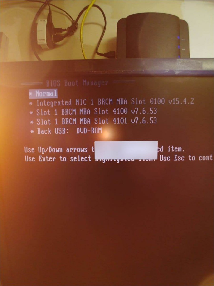

Well, I give up, at least for today.
Maybe I bricked the card, no idea right now.
I can see the drives during the install and pick the 2 146GB drives.
I get no options to mirror or anything else.
No matter if I pick EUFI or BIOS as the boot device, none are seen after the install.
I found some threads on this but nothing that helps so far.
When I boot, I get an F1 to continue, F2 to setup and F11 to pick the boot device.
Done for now, bad day.

Note, you may also need to flash the boot ROMs (legacy and UEFI) to enable booting from downstream drives.
How do I confirm if this is the case? I don't want to completely trash this server by flashing all sorts of things rendering it useless and have to start over. Need to start searching on this now so I can move forward again.

I didn't see any options to flash the boot roms so I'll go back to the documentation on flashing the card to start with.
Ok, so how do I confirm if that is my next step.
If you're trying to boot from downstream drives, but they don't appear, it's a pretty good sign you'll need to flash the boot ROMs back onto your H710.
Apr 26, 2015
320
To me, nothing is that clear right now.
I read the entire doc seeing this part over and over.
>If you need to boot from drives connected to this adapter, you'll need to flash a boot image to it. Otherwise, skip it. This is what
>gives you the "press blahblah to enter the LSI boot configuration utility" text when the server boots. To flash the regular BIOS
>boot image:this time, figured I'd try this;
While this seemed to be the problem, I wasn't sure if it was safe to do this at this point but decided to go ahead.
# flashboot /root/Bootloaders/x64sas2.rom
Then I was able to see Avago and the drives when the system boots.
