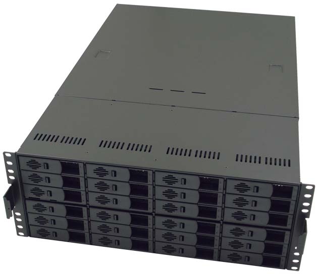

I remember years ago having a client pay $175/hr for some acute issue to a "major player" where we needed a power cycle (not a reset) of a server. This was in the mid-2000's before IPMI was really popular and when the 24-in-4U layout was still brand new; the power and reset switches on the AIC RMC4E2-XP were on the back panel.
We knew that a failed disk could hard-wedge the 3Ware RAID controller. Smarthands had no problem pulling the correct disk. But sometimes it's the simple things that get you...
So if you look at the bottom right of the back panel you'll notice a red and a black button, plus symbols for power and reset. Spent over an hour trying multiple "power cycles" because that was the only way to clear the 3Ware RAID card. Turns out the dum-eff had been pressing the red button when he'd been told to "power cycle" the unit, and the other dum-eff on the other end of the phone line (i.e. me) hadn't picked up on this. We kept going through this long ~ten minute boot cycle and the 3Ware card would just hang (because the controller had crashed).
Needless to say I was not impressed that "smarthands" couldn't identify the symbol for power.

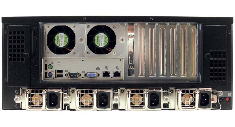

"950W 3 + 1 hot-swap redundant power supply" :eek:
My NAS is feeling totally inadequate now. Only one 650W power supply (and that runs at <25% of capacity at peak, 13% during idle)

Oh those effin' Zippy-Emacs things were the bane of my existence throughout the 20[04-12] era. That and the crap-grade backplanes AIC used.
The PSU modules were something like 325W each. The problem is that in a facility with redundant A+B power, the loss of a PSU on A meant that if the B rail failed, the other A PSU would be instantly overloaded, and would smoke itself. Then when the B would come back, the ~600W available was really not sufficient to restart the system and things would brownout. And the modules weren't real high quality, so modules blew with somewhat alarming regularity.
If anyone ever wondered why I go on such a tear when people under-size PSU's, ... ah, experience.
But that was what it was like in the early days of SATA. We were one of the earliest shops doing large scale SATA storage servers for FreeBSD.
