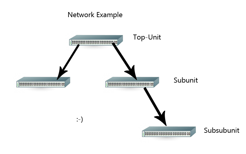

I tried to outline it with the attached graphic:
Managed switches can be wherever you want them. However, the closer you get to the top, the more management stuff you generally want.

There's no "top" or "subunits" in a switched network, except perhaps for specific considerations such as the spanning tree topology, which the switches can figure out for themselves. Any of your switches can be managed or not. Obviously this may limit the capabilities of your network, but there are no hard rules about placement of managed switches.
If you are cascading a large number of 10G switches one after another, this of course creates a lot of forwarding and you might be better off with a different topology.

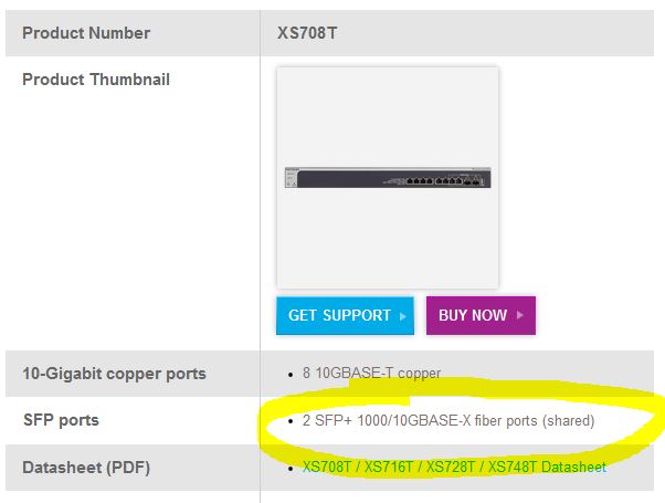

Have a look:
https://netgear.com/business/products/switches/smart/XS708T.aspx#tab-techspecs
The copper parts are 10GBASE-T. The SFP+ ports are 1000/10GBASE-X.

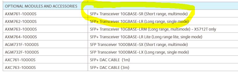

However, one of the SFP+ modules listed in the optional part list is a 10GBASE-SR module:
PDF, last page: http://www.downloads.netgear.com/files/GDC/datasheet/en/XS712T-XS728T.pdf
That's the point I don't get... The SFP+ Ports of the switch itself are 10GBASE-X, however the SFP+ Transceiver aren't... So, I'm wondering if it is still recommended to use such a switch, since 10GBASE-X shall be avoided and is just crap ;)
No, the SFP+ ports are SFP+ ports. That's it. All the physical layer details are abstracted away by the SFP+ modules. That's the whole point of SFP modules.

You've created your own confusion. You asked about "10GBase-X" in the context of a signal encoding type, so I answered your question in the context you provided. "Don't use that, it's total crap."
This in no way suggests that every time you see "10GBase X" that they're talking about CX4 or LX4 (and I pretty much even warned that nobody uses that terminology). CX4 and LX4 are not actually true 10G, they're 4 x 2.5G aggregated together. They function as 10G, after a fashion, yes, but they have to run through a switch or interface chip in order to be "usable".
But there was also "1000Base-X", used to denote a range of 1G ethernet options that were mostly fiber, from the common 1000Base-T UTP copper. In general the 1000Base-X options used modules, usually swappable, sometimes fixed, and so generally people might refer to things that weren't UTP as "1000Base-X" and even be almost completely correct. I would take "10GBase-X" to be a generalization of that for 10G, and it's easy to find examples of such use in industry. The very fact that they say "SFP+" means it is *impossible* for it to be signal encoded as 10GBase-X. There aren't four channels available on SFP/SFP+.
You do NOT want to learn all about this crap. I do not want to REMEMBER all this crap. Just trust me here. Go get yourself some happy SFP+ gear, or happy 10GBase-T gear if you don't mind spending $$$$.
For SFP+ stuff, check to see if you need a manufacturer-specific SFP+ module, and if so, get them. SX fiber is very affordable and hooking fiber between devices is a very highly compatible way to make sure stuff "just works."
