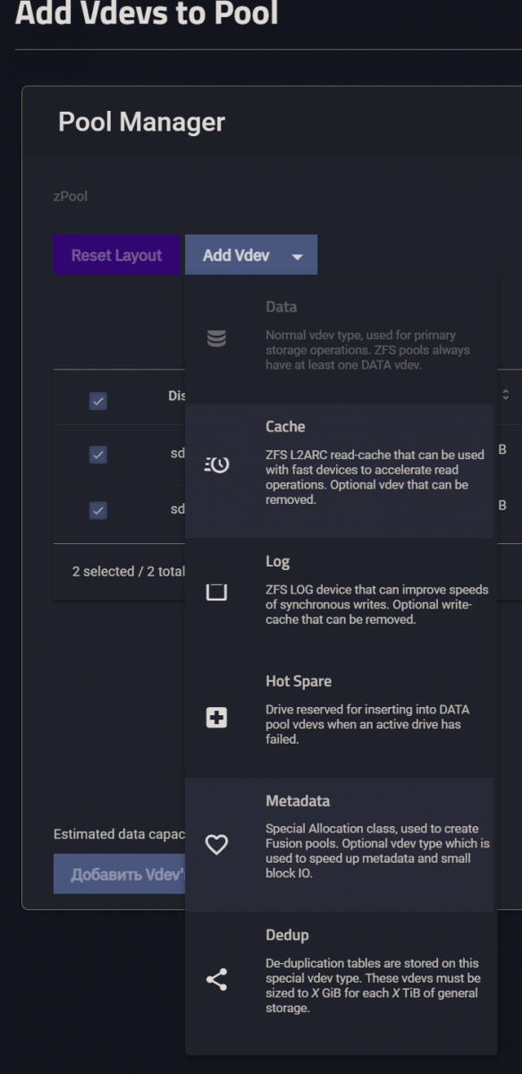

hello everyone, can you please advise on a few things:
1) https://www.truenas.com/docs/references/zfsdeduplication/
I see that Deduplication can use ARC/L2ARC and it can use SLOG?
2) in a normal situation De-duplication tables be stored in Metadata? or as a separate table?
3) I don’t understand for what exactly, in what use cases, Metadata may be needed?

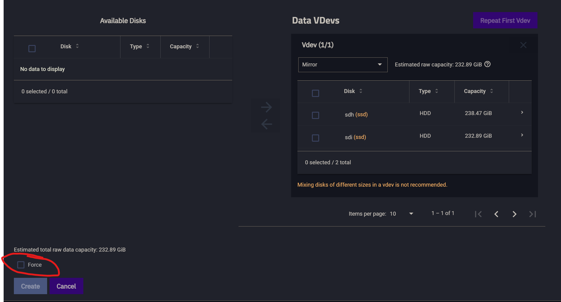

4) I found 2 ssd disks, I wanted to use them for cache, but they seemed to be a little different size - 238.47 GiB and
232.89 GiB , it says to me - "Mixing disks of different sizes in a vdev is not recommended." -
a) Could I force VDevs? (for example, a mirror) and what will happen then? it will only use ~232GiB ?
b) or should I somehow cut off partitions of the same size with my hands and make VDevs already on these partitions?
5) can I make Data VDevs on it, make 2 Zvol, and then use them as Cache VDev (L2ARC) and Log VDev (SLOG)? or do I need to cut them into 2 sections, and feed them as devices?

1) does deduplication use SLOG?
2)if I have "Vdevs Metadata" but don't have "Vdevs De-duplication tables" then De-duplication tables are stored in Metadata?
3) I think you answered my question
I will rephrase the following questions.
4)
I found 2 ssd drives, I wanted to use them in the vdev mirror, but they seem to be a slightly different size - 238.47 GiB and
232.89 GiB, tells me - "Mixing disks of different sizes in vdev is not recommended." Can I force create VDevs? will it only use 232.89 GiB from each drive? (the size of the smallest of the drives) or if it exceeds 232.89 GiB, it starts to write data to only 1 disk and then I can lose data?
5) how do i get my 2 ssds to be used as both SLOG and L2ARC ?
Arwen
May 17, 2014
3,611
1 - I don't know, and I doubt it. Please note a SLOG is not a write cache. It is a separate write log, (all pools have an internal write log, called ZIL, ZFS Intent Log). ZIL & SLOG are only useful for synchronous writes, like for NFS or iSCSI. Thus, my question about your use case.
2 - Yes, if you don't have a Special vDev for De-Dup tables, they will be in the normal pool vDev(s). But, note that De-Dup tables are loaded in to memory on pool import. (And written to stable storage on update.)
4 - Yes, you can mix device sizes in a vDev using the Force check box. The vDev will simply use the smaller of the 2 devices. The GUI has a set amount to check for size differences, and your 2 devices triggered it.
5 - You don't through TrueNAS GUI, that is what I meant about manual effort. This could have changed. Basically if you can't do it on your own, then you almost certainly can't support it on your own. But, in general L2ARC cache is not mirrored because the pool data vDevs contain 100% of the data. And depending on use, Mirroring of a SLOG would be recommended.
