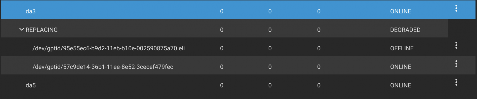

I ended up copying what was done to another disk of the same type:
so I had:```
# gpart show -l da0
=> 40 7814037088 da0 GPT (3.6T)
40 88 - free - (44K)
128 4194304 1 freebsd-swap (2.0G)
4194432 7809842688 2 freebsd-zfs (3.6T)
7814037120 8 - free - (4.0K)
and I did:
# gpart create -s GPT ada2`
# gpart add -t freebsd-swap -b 128 -s 2G ada2`
# gpart add -t freebsd-zfs -s 7809842688 ada2`
# gpart show -lada2
=> 40 7814037088 ada2 GPT (3.6T)
glabel status showed me the gptid for ada2p2
zpool replace pool gptid/95e55ec6-b9d2-11eb-b10e-002590875a70.eli gptid/57c9de14-36b1-11ee-8e52-3cecef479fec
Only thing is that the GUI isnt showing me `ada2` as the drive being used like all other disks, but the GPT partition instead.

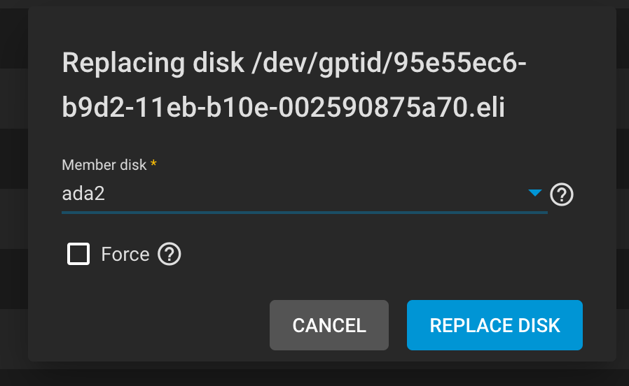

If I add a new disk, replace the broken disk with that new disk: what is added is the geli device
jyavenard
Oct 16, 2013
361
there's no way the GUI can put legacy encryption back.
So turned out the replacement disk was broken too. So I replaced it again with another.

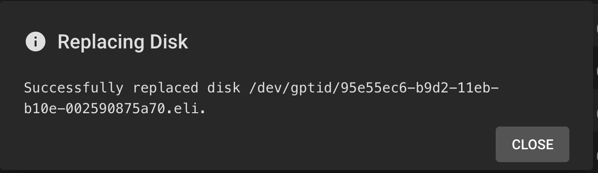

so I inserted a new disk, it's now in /dev/ada2
disk got replaced:
And this is what TrueNAS actually replaced with:

seem a bit silly to tell that TrueNAS 13's geli is legacy and to stop using it, only to have the GUI use it again.
9,703
Just to be clear, from what I can see, the disks that replaced the .eli encrypted ones also become .eli... that's what I expect.
But if, as I said, you removed the .eli disk from the pool already and the only replica of that member is not .eli, then it can only give you back an unencrypted one.
Anyway, it's a little hard to read what you posted there to confirm that or not, but it's what I expect.
