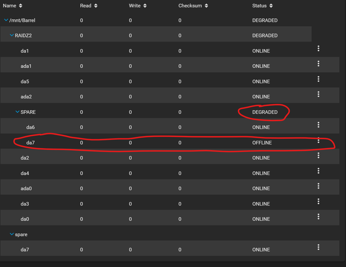

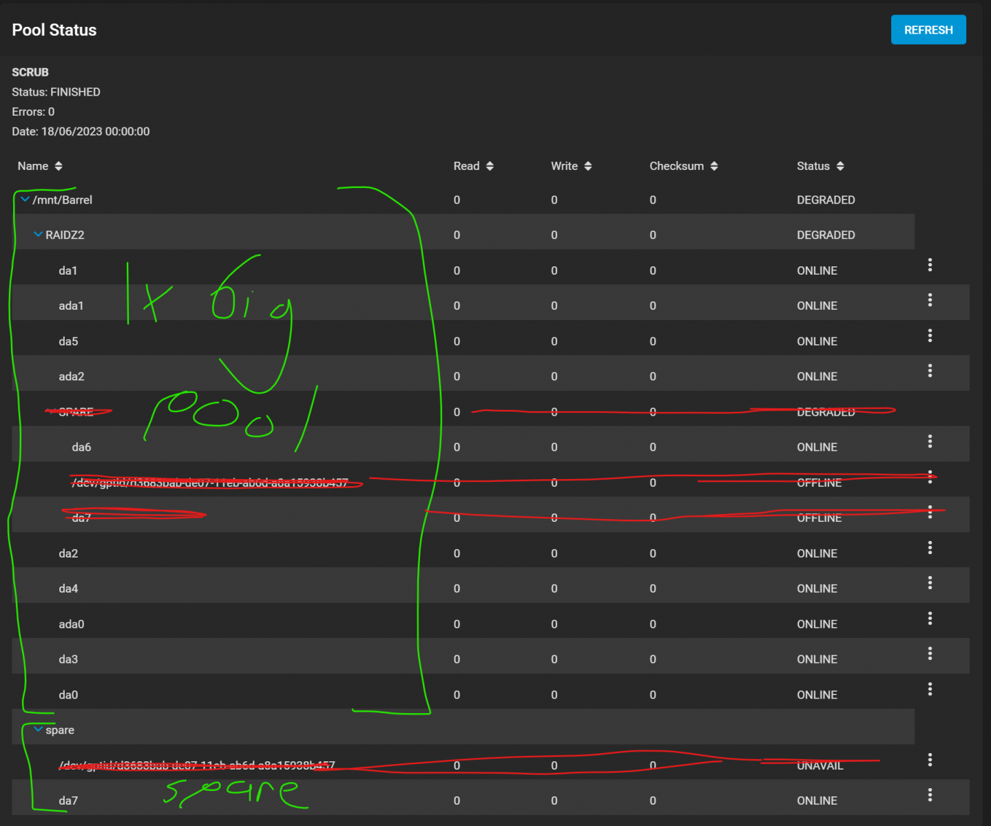

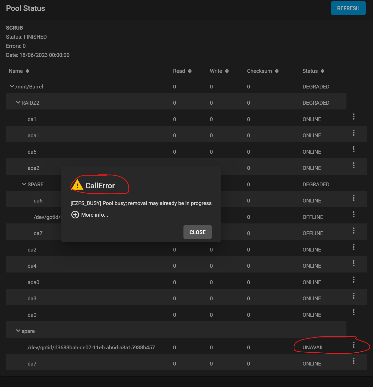

Replaced Disk Duplicates / Not Detaching or Removing (have been researched a bunch of threads).
Jimbob
Jun 8, 2023
19
Looks like one of your hot-spares kicked in and after replacement didn't go back to being a spare (this is a bug that was only recently fixed in U5.
Have you tried zpool detach Barrel gptid/d3683bab-de07-11eb-ab6d-a8a15938b457
Ok JFP.. that worked to a degree.. looks kind of closer to where it should be.. there is a weird SPARE duplicat going on.. da7 should be the 1x hot spare (in red).. instead there are 2x spares online which I didn't set up (da6 / da7) & the pool is non degraded.. which just sort of appeared post drive replacement.. there should be 10x drives in the pool with 1x hot spare..
Does this matter? My OCD is driving me a bit nuts.. as my gut is saying if it looks / feels wrong it probs is.. LMK.. thank you!
