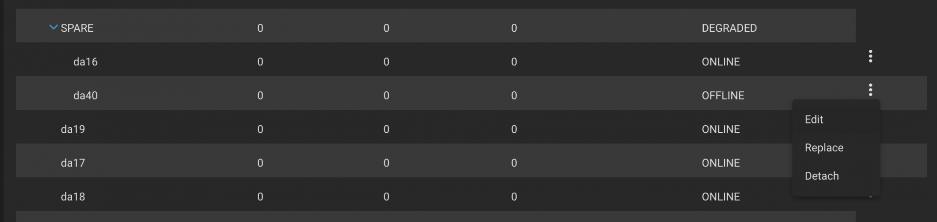

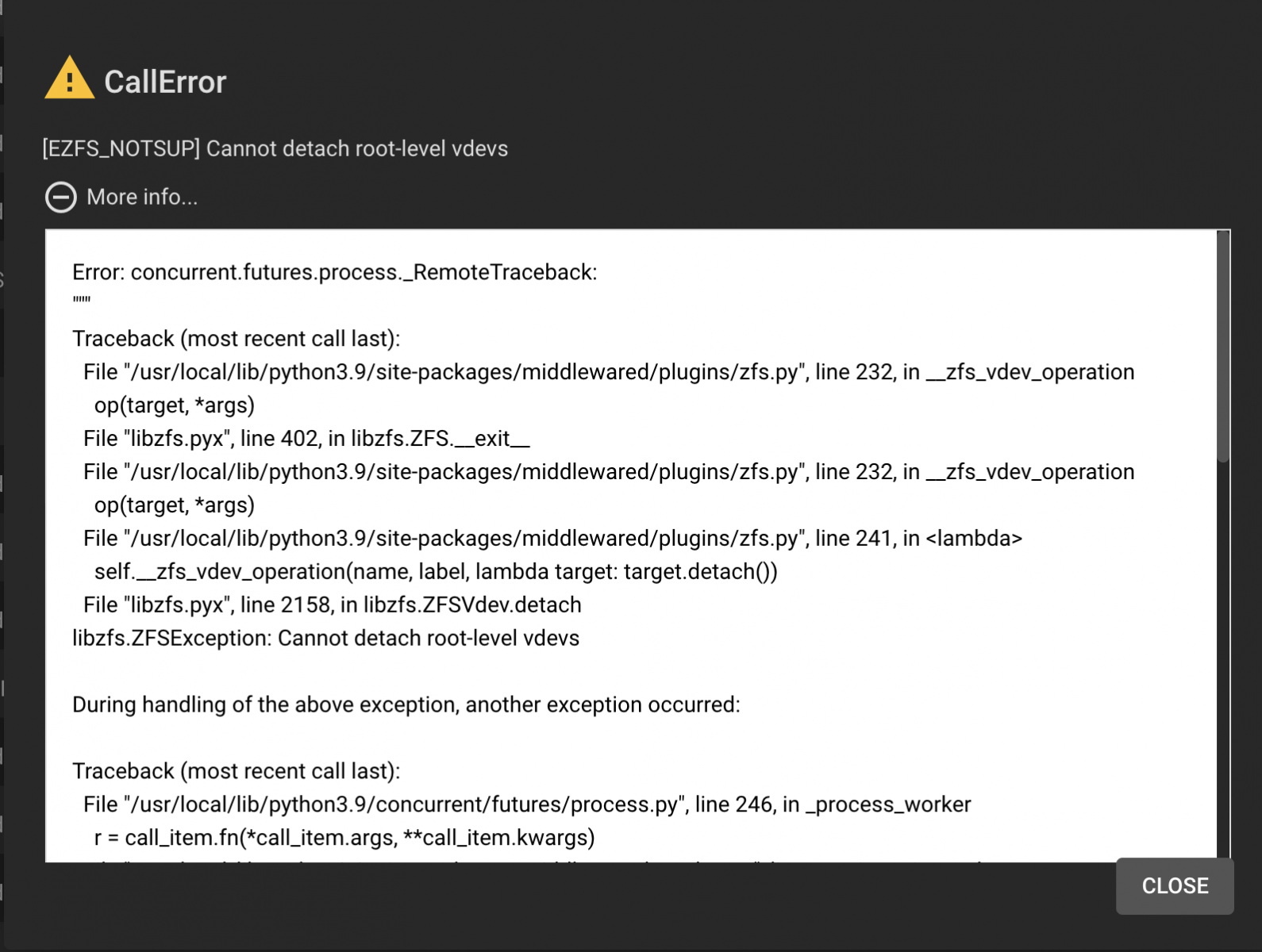

I recently had a drive fail (da16), and one of my hot spares jumped in (da40). I got the notification, so I went to the UI, put the failed drive offline, and then shut down to replace da16. I put the new drive in, and started back up and let it resilver. When it completed without problems, and both drives were online, the spare did not return automatically to the spare pool. Instead of detaching the spare, I put it offline (doh!). It did not return to the spare set, so I tried to detach it, and the UI gives this error:

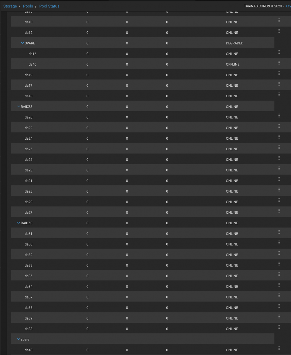

Even though the operation was unsuccessful, I do now see da40 back in the list of spares and ONLINE. However, it is also still in the pool where it originally jumped in as a spare:

So I'm a little stuck. da40 (gptid/0d93ec08-4c57-11eb-b083-3cecef6e76ba) is no longer part of the pool and is back in the list of spares, but zpool status still shows it in the output.

I don't have the option to online the drive from the UI:
I have rebooted multiple times, but no change.

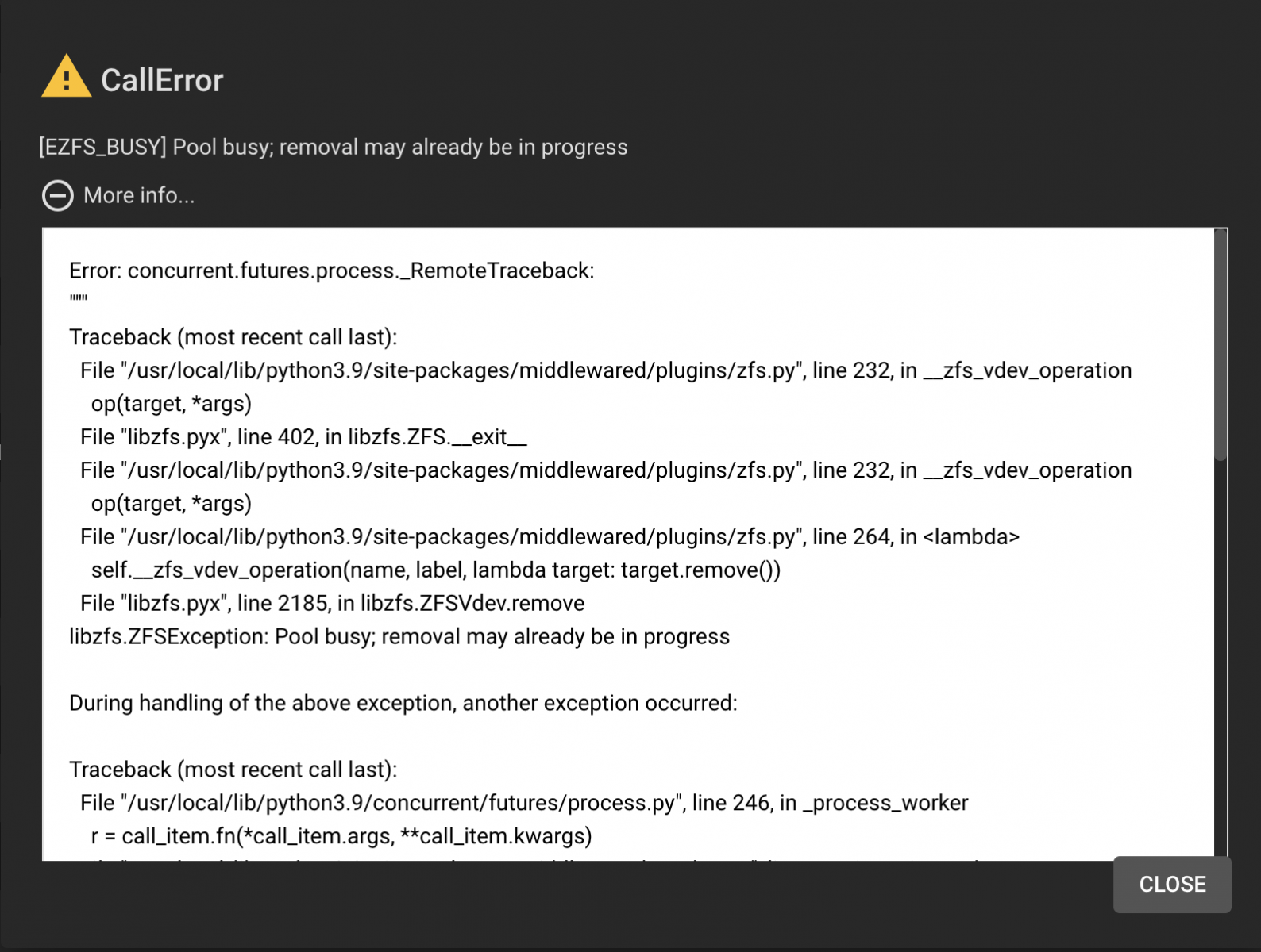

When I try and remove da40 from the spares list, I get this error:
