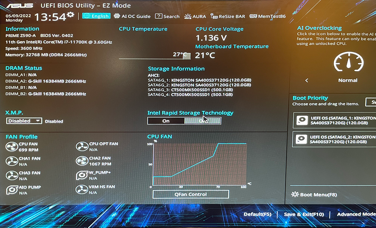

It is a i7-11700K with an ASUS Prime Z590-A Mobo and 32GB (see pic) running TrueNAS-12.0-U8

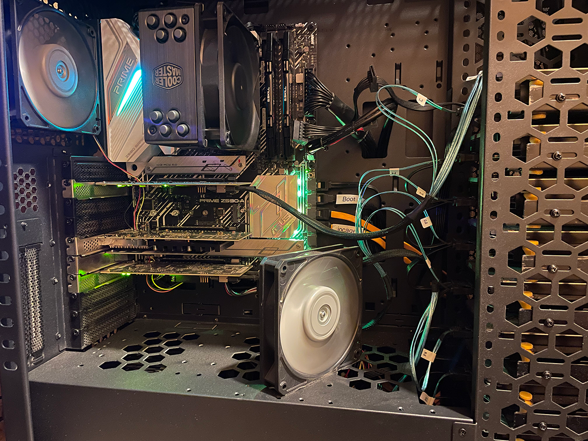

HDD are in shock absorbent wiggly mounts and are kept very cool with 4 Gentle Typhoon frontal fans.
Boards have their own fan blowing air on them, mostly because the Chelsio NIC gets hot and is passively cooled

Well damn. Usually it's easy to find a culprit or two. My only criticism would be the lack of ECC, which could potentially cause an occasional problem. Which could be what this is. But it's so much nicer to have a specific correction suggestion.
Your HBA's have vented blanks and while maybe not optimal airflow, they do have clear space, so overheating is not likely. Like the Chelsio, the HBA's are server cards and expect airflow to be forced over them. The fan should be sufficient.
