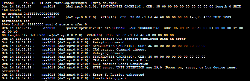

Here is /log/messages about this drive :

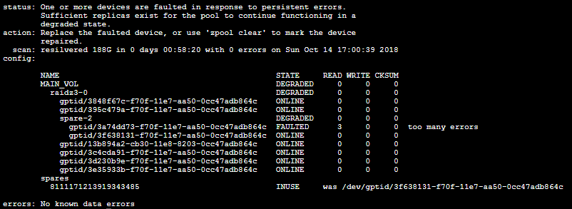

here is volume status :

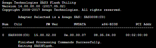

controller is LSI Symbios logic SAS3008,

I suspect thoses last line to be the error reason :
0x0009 4 6 Transition from drive PhyRdy to drive PhyNRdy
0x000a 4 6 Device-to-host register FISes sent due to a COMRESET
cause the message log say "UNIT ATTENTION : poweron, reset or bus device reset occured) (see captured screen before)

Second, you should run the short and long SMART tests on the drive via the CLI to see if anything jumps out (I think it's odd that in your post above, there is nothing in the printout so this would be a good place to start)
If you're not already familiar with the tests, you'll want to run the following:
smartctl -l selftest /dev/da2
This will give us some more information surrounding the last tests performed on the drive and a rough idea of the results.
For reference, here is the output on my drive:
root@freenas:~ # smartctl -l selftest /dev/da2
smartctl 6.6 2017-11-05 r4594 [FreeBSD 11.1-STABLE amd64] (local build)
Copyright (C) 2002-17, Bruce Allen, Christian Franke, www.smartmontools.org
Num  Test_Description	Status				  Remaining  LifeTime(hours)  LBA_of_first_error
# 1  Extended offline	Completed without error	   00%	   252		 -
# 2  Short offline	   Completed without error	   00%	   118		 -
Then we can move into investigating a bit more and start identifying what could be contributing to this.

I also see you mention there is an LSI SAS in play, are all of these 'failed' drives connected via the same card? (Very similar to my setup so I want to help where I can)
teji
Oct 16, 2018
6
Yes all the 8 HDD on the SAS3008 card.
i just tried to disable "smart" option for this drive, clean errors, put this drive offline/online, wait for end of resilvering. Now it's "Healty". This way to do it work always fine with this problem, but only for 2....5 days.
Then i will see if removing smart will solve the problem.
I don't know if REAL problem will be detected if smart is off ....
if problem come back, il will put this drive offline and run extended smart tests....
