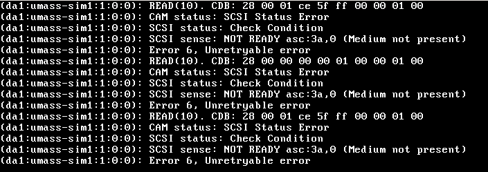

Came home from work to find my FN Corral install wasn't working. After a little investigation I found that my ZFS pool was DEGRADED. I might add I was running boot USBs in Mirror and the system was providing the following errors:
Despite the mirror regardless of which USB was in the system would not boot - thanks Corral! :(

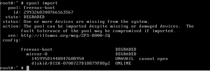

OK plot thickens on this - so after reading the error message properly one of my mirrored drives has failed:
What would be the best way to resolve this and import the zpool to pull off the decryption key?
