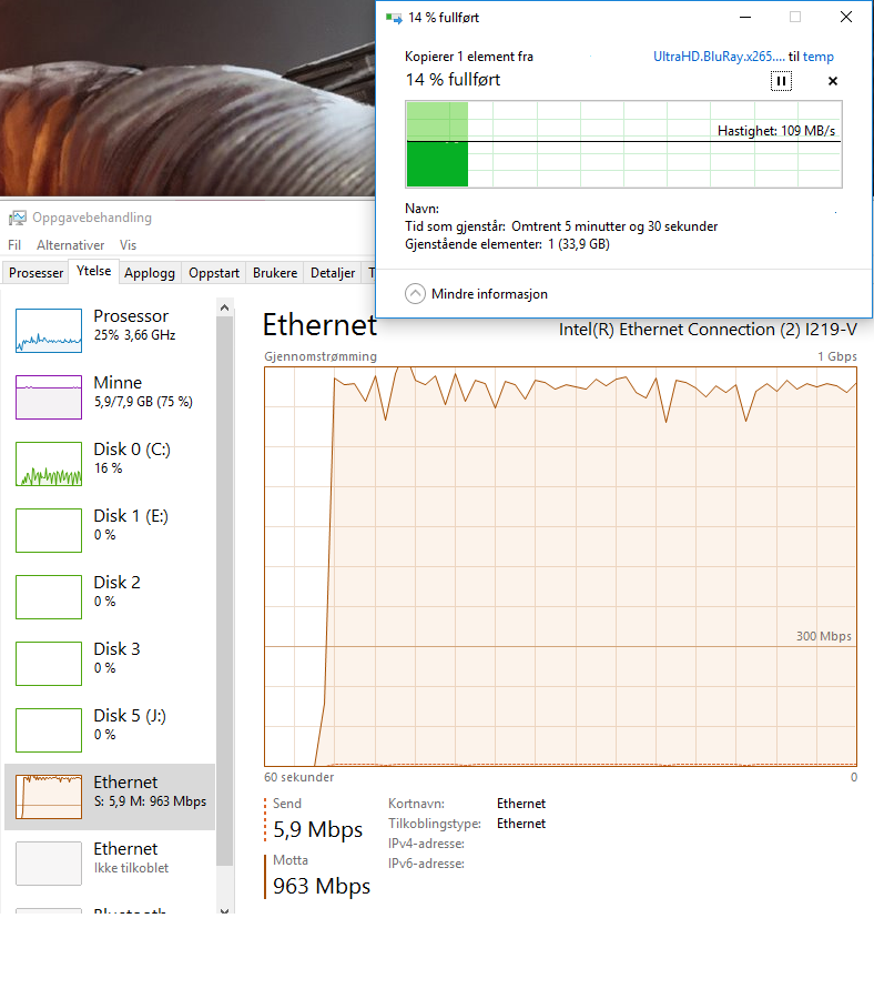

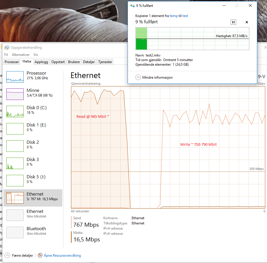

Included screenshots, of a transfer of 25gb file to and from the Storage Raid.
The Storage raid is 18x3TB WDred in RaidZ2... it's running Gelid encryption.
Performance to the 8x 10K sas drives are a little bit higher write, around 92 MB/s.
How can i improve it ? I want the Write speed to match the Read speed. the Read speed is as expected.

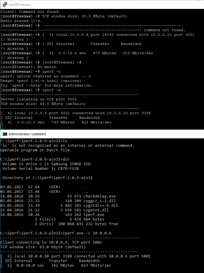

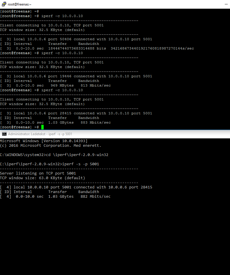

So i did some more research, thanks for pointing me to iperf. there is a quite different performance gap between read to nas, and write to nas. seems i have to figure out how to tweak the tcp settings maybe then ?
Got 882 Mbits from NAS , default settings. Got 623 mbit to the NAS, default settings. (just iperf -s ,and iperf -c. ) i see the difference in tcp window size varies a lot.the NAS reports 32,5 KB. the windows pc 63 KB. i have to read up more on this matter.

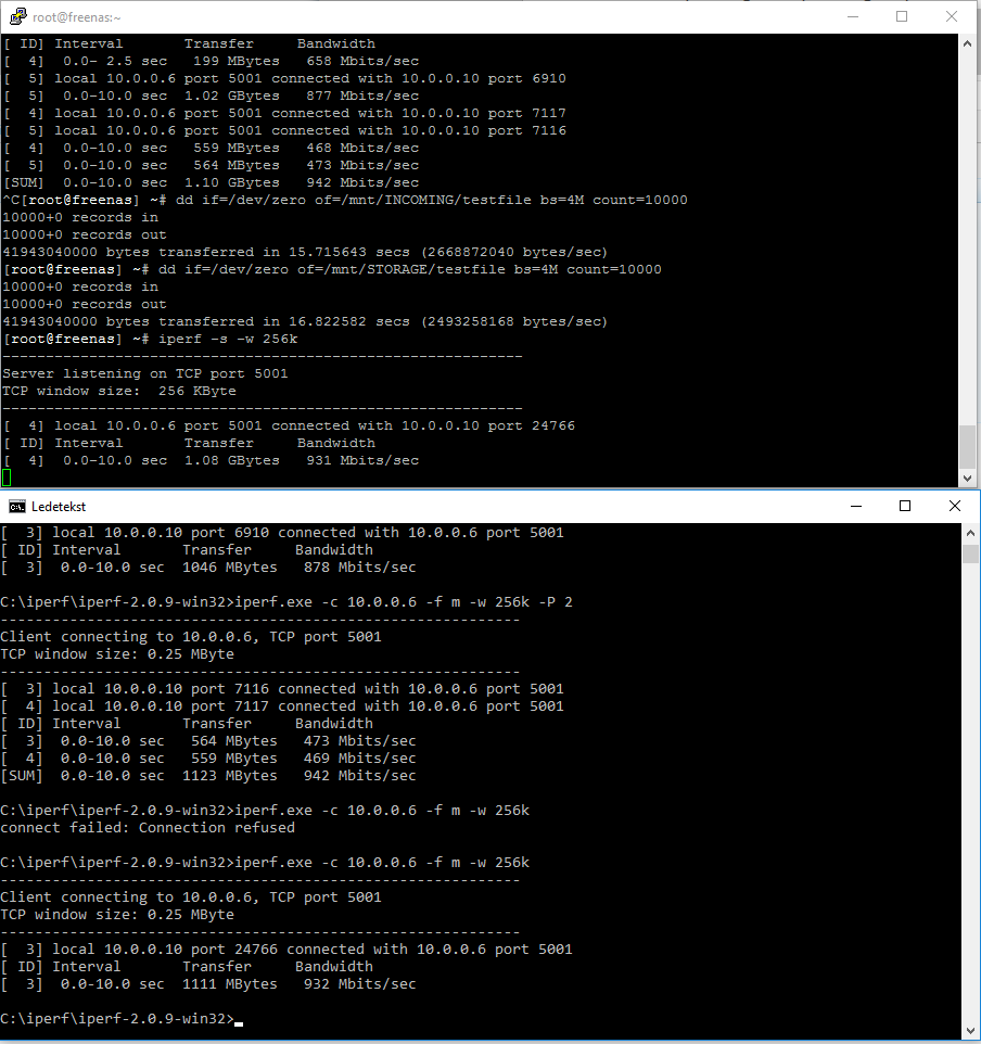

I managed to get 931 Mbit in a single thread write to the NAS , when doing -w 256k (window size 256k).
How can i apply this improvement to "real world cifs performance" ?
This rules out my windows NIC, and ethernet switch as bottleneck . (i do get ~full wirespeed windows to windows)
