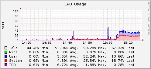

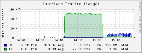

To test the changes, I copied the 867 files from the server to the SD card. It took 19 minutes - acceptable over wireless for the 3+Gb.
I then started a copy from the SD to a new folder on the server. Back to the slow speed.
The copy to the SD went from around 14:40 to 15:00 and the copy to the server from the SD card started just after 15:00 the CPU, Load and Network charts are attached.
Needless to say the same data copied to and from a Windows machine is very very fast.
The good news is that the log file messages have stopped, but it is creating a new 52Mb log file every 8 minutes. Something is still wrong here.
I will do another test connected via cable.
