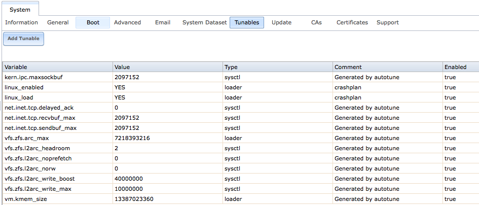

I disabled it, rebooted, and all the tunables that autotune created persisted. Autotune is off now, and I still have the performance improvements I experienced after enabling it. System load is quite healthy, and I am maxing-out gigabit on large file transfers. I am attaching a screenshot of all the tunables:

hm, as far as I understand (and I stand to be corrected) autotune simply creates those tunables. Since you left the tunables enabled, disabling autotune shouldn't have any effect. You'd only see the effect if you disable them too!
My autotune only created these 2 with no noticable effect:
Variable
Value
Type
Comment
Enabled
vfs.zfs.arc_max    5037514880    loader    Generated by autotune    true
vm.kmem_size    10660925440    loader    Generated by autotune    true

Yes, agreed with respect to the autotune persistency. I didn't know if they would persist until I tried it. It is likely deleting the tunables would result in poor SMB and AFP performance once again, but I am not going to pursue disfunction on a production box any further for the benefit of this thread.
Also, autotune populated values over several days/reboots, so I wouldn't be surprised if more appear for you. I was surprised.
