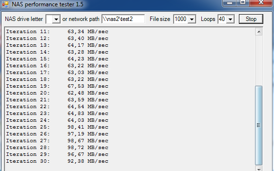

Nas Tester
NAS performance tester 1.5 http://www.808.dk/?nastester
Running warmup...
Running a 1000MB file write on \\nas2\test2 40 times...
Iteration 1: 63,09 MB/sec
... All around 65MB +-3MB
Iteration 20: 62,48 MB/sec
Iteration 21: 63,59 MB/sec
Iteration 22: 64,54 MB/sec
Iteration 23: 64,83 MB/sec
Iteration 24: 64,03 MB/sec
Iteration 25: 98,41 MB/sec
Iteration 26: 97,19 MB/sec
Iteration 27: 98,67 MB/sec
Iteration 28: 98,72 MB/sec
Iteration 29: 96,67 MB/sec
Iteration 30: 92,38 MB/sec
Iteration 31: 96,16 MB/sec
Iteration 32: 98,13 MB/sec
Iteration 33: 97,08 MB/sec
Iteration 34: 95,61 MB/sec
Iteration 35: 95,96 MB/sec
Iteration 36: 97,27 MB/sec
Iteration 37: 92,66 MB/sec
Iteration 38: 94,79 MB/sec
Iteration 39: 97,00 MB/sec
Iteration 40: 87,86 MB/sec

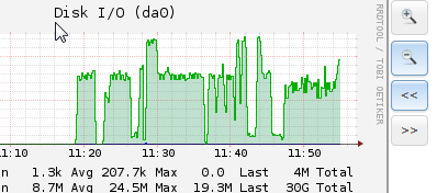

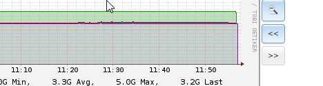

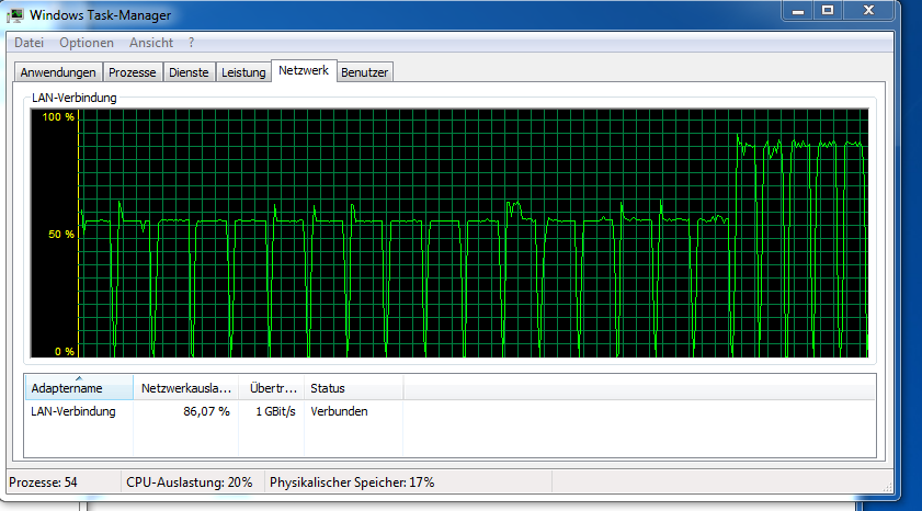

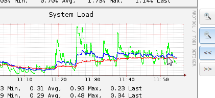

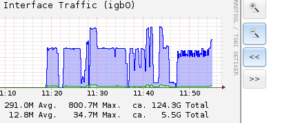

Windows Lan Performance:
FreeNas Disk (1 of the eight, all identical; peaks show increased speed)
Similar behavior on network
Memory is in constant use
Server Load 1
Load 2

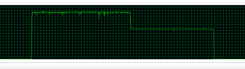

Edit: Found the screenshot of the 32GB dropoff - this is a 64GB random data transfer

Ah didn't know you were updating this thread as well as the bug (#4145).
The traffic graphs are _very_ interesting since it looks extremely abnormal. I see the toothyness on my 4-disk RAID10 test rig -- that is the dropouts I've been explaining -- but not a 30% delta between transaction groups. That looks a lot like some sort of throttling or change in the workload generation method, especially with it just coming and going at very distinct boundaries. Nothing in FreeNAS commands that type of throughput change.
Are you running a firewall or using a switch that other things on it or has a traffic management policy in place? Is there background tasks running on the test client, or a screensaver? Or a scrub, periodic snapshot, or replication on the FreeNAS side? Are you getting ZFS or disk errors on one of the disks that might cause it to get kicked out of the array?
We need to eliminate possibilities here...

For those of you not following the bug,
I just found that on my test E3-1270 v3 system that turning off HyperThreading fixed the write performance issues entirely. I went from very poor, unstable throughput (20-50MB/s) to saturation levels (110MB/s +) by turning off HTT. Read performance was never a problem.
This likely means there is inter-thread or lock contention that is exacerbated on a fast core system with more than 4 cores (or at least E3-12xx v3). Next step is to run with lock profiling to figure out what is special in that setup and see what can be done to mitigate it.
Haswell cores are particularly fast so this likely doesn't come up on Sandy/Ivy Bridge. It wasn't seen on dual-core Haswell desktop CPUs either (i3-4130T specifically), for the record. I don't have a i5/i7 Haswell chipset board (or CPUs) to test higher end configs yet.
