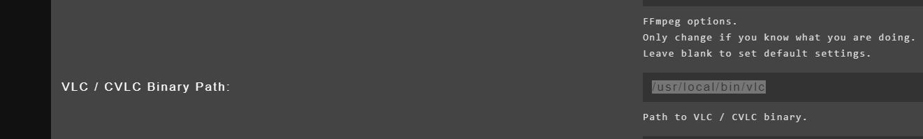

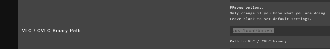

Hi Jorge, yesterday I bought one IPTV subscription for 2 devices, for me xteve work fine for 1 device with nobuffer selected in settings but only buffer option can get me 2 devices play at same time. Unfortunately vlc and ffmpeg options dont work for me, they are install and vlc modified to work in root but not working. it work at your side?

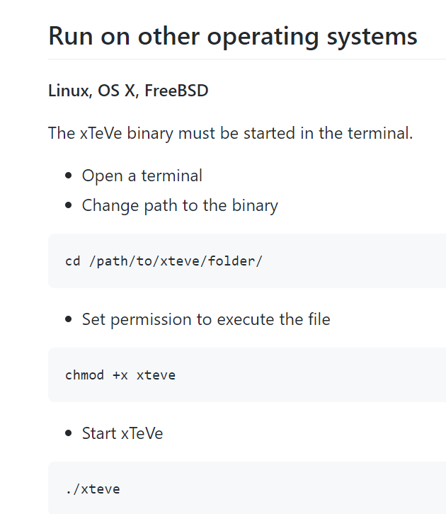

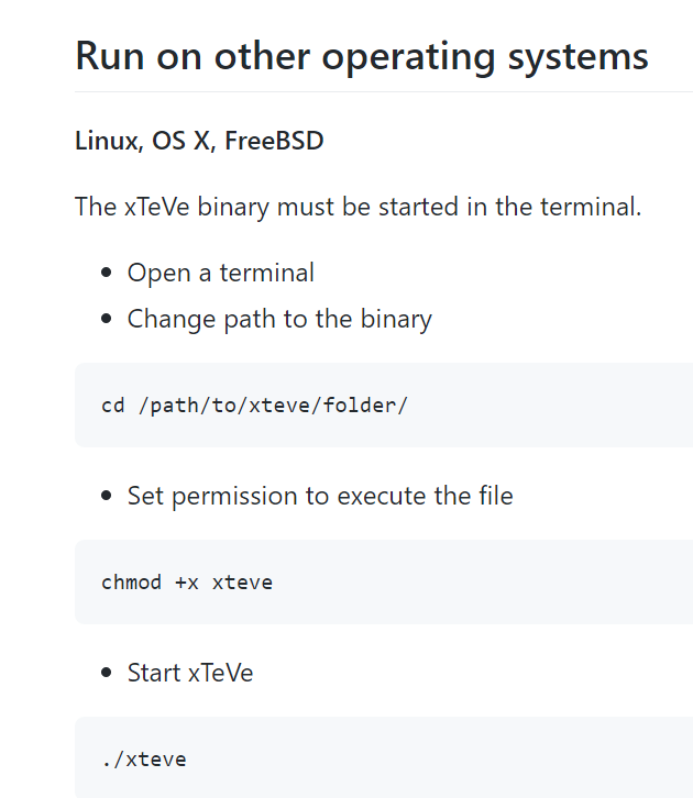

Hi jorge12355,
I am having difficulty getting the xTeVe binary working within a jail. Could you give a general overview of how you done this?
I am running the latest stable release of TrueNAS. I have created a blank jail and try to point it to the xTeVe binary but it continually specify that the pathway does not exist? I have been running the Plex within a jail with no issues for a couple of years and I would like to add my IPTV to this as I have a Plex Pass. However, I cannot seem to find an easy guide on how to install xTeVe within a jail.
Your help is appreciated,
one does your provider support more than one connection? Second, when you select the buffer option set it to 0.5 MB also the good thing about buffer is that you can play the same channel on other devices and it counts as one connection for your provider. Now in order to get VLC to work, I installed it pkg vlc install. Then you have to find the path where the vlc application is and insert it in your setting in xteve /usr/local/bin/vlc.
I have my xteve running as a user not root, so you have to give that user permissions to that vlc location. I hope this awnsers your questions.

Hi jorge12355,
WhiskyG
wget https://github.com/xteve-project/xTeVe-Downloads/blob/master/xteve_freebsd_amd64.zip?raw=true

Thanks for pointing me to this, however, I am obviously being stupid here and missing something real easy. I have looked at these steps before. I have a jail up and running, I have the binary downloaded and saved in a main directory on the server. When I use the command "cd /path/to/xteve/folder/" (changing this to the folder where I have saved the binary.). It gives me an error saying "no such file or directory"....
WhiskyG
Jan 18, 2021
6
Seem to have got it working. Thanks. Perseverance is key!!!

one does your provider support more than one connection? Second, when you select the buffer option set it to 0.5 MB also the good thing about buffer is that you can play the same channel on other devices and it counts as one connection for your provider. Now in order to get VLC to work, I installed it pkg vlc install. Then you have to find the path where the vlc application is and insert it in your setting in xteve /usr/local/bin/vlc. View attachment 44443
