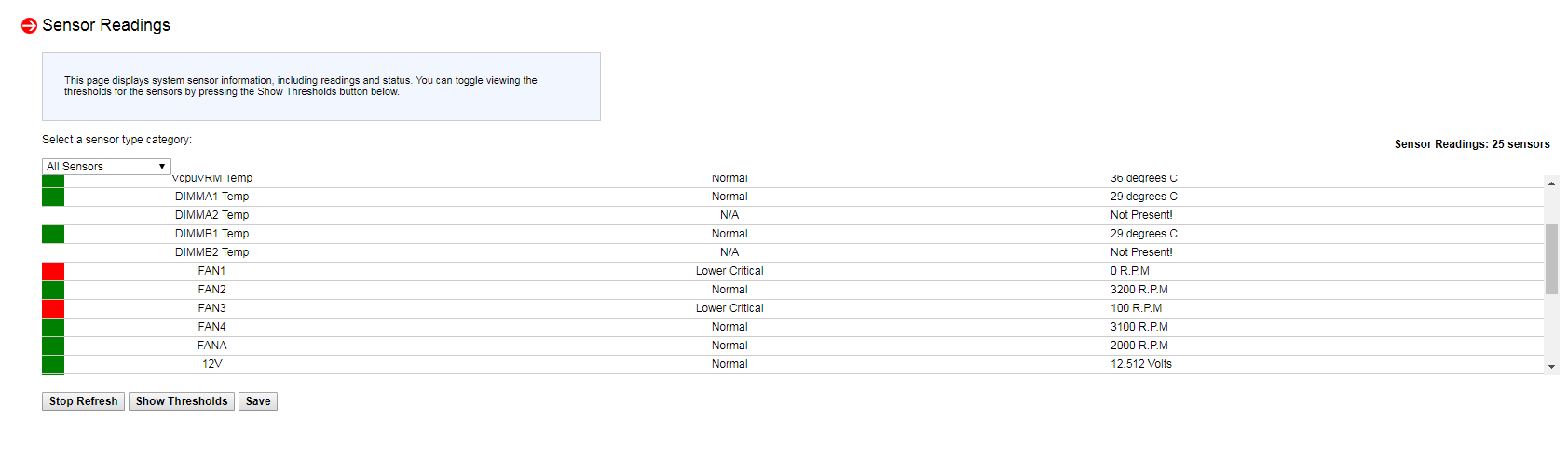

-- BMC version 1.48, IPMI version 2.0
ID | SDRType | Type |SNum| Name |Status| Reading
025f | Full | Fan | 41 | FAN1 | OK | 3100.00 RPM
02a2 | Full | Fan | 42 | FAN2 | OK | 900.00 RPM
02e5 | Full | Fan | 43 | FAN3 | OK | 300.00 RPM
0328 | Full | Fan | 44 | FAN4 | OK | 3100.00 RPM
036b | Full | Fan | 45 | FANA | OK | 2000.00 RPM
ipmiutil sensor, completed successfully
tried 041 any way and it try to change 04 and failed
and i all ready got fan set to full speed, trying work out why not stable (so much easier on desktop motherboard ;))
