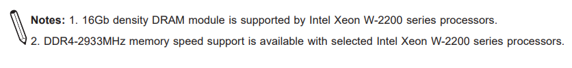

Extra question if I may about the RAM :
I found the following used RAM online and would like confirmation about the compatibility
RAMX10 compatibleX11 compatiblePrice for 32GB
M393A4K40CB2-CTDyes75$
M393A4K40BB1-CRCyes?50$
HMA84GR7MFR4N-UHyes?100$
There are some differences in the speed and Cas Latency, but they are all ECC, RDIMM, 32GB.
So the question is : Are the "old" RAM still compatible with a X11 board ?
If so, do we agree the CRC RAM module (2nd row) will be compatible with a Xeon W-21xx too ?
I've read in the supermicro motherboard documentation that a Xeon W-22xx is required to handle 16Gb density DRAM.
And looking at the spec sheet of the RAM it seems the density is at 8GB.
I just want to be extra sure before buying anything...
Regards,
Etorix
Dec 30, 2020
2,134
In principle yes but 2400 MHz modules will, obviously, limit speed. The CB2 modules look like the obvious choice for a Xeon W-2000.
