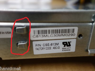

I noticed that the page you liked to for the MCP-290-00004-03 rail set is the official Supermicro Store. I'm almost certain that if that model fit more than one chassis
model, that they would have listed the numbers on the website. I tend not to look at picture when shopping the internet and go by description almost exclusively. My recommendation... Buy the product number that is stated to fit your chassis. BTW, did you notice the rectangular slots shown in the pics of the CSE-PT52L?
These fit over the tabs on the sides of your chassis, see example photo below.
