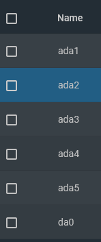

Using an ATA RAID card to connect two Hitachi DeskStar SATA HDD, both drive are being seen in the RAID card.
And when booting to FreeNAS both drive are seeing by FreeNAS. However, when the drive are being added to a new pool, the wiping process always failed on ada0, independent of the drive attached. This is also the same drive recognized as drive 0 in the RAID card. I am starting to thing that might be a bug in the code while wiping drive 0 while attached to the RAID card. Please keep in mind that there are no VHDD created. After the wipe fails, the drive ada0 is removed from the pool and I can't see it any more. Contrary to, if, the drive is process through the RAID card, they are both wipe and configured in a RAID1 without any issues.
Any assistance is greatly appreciated.

Thank you for your response Redcoat. The card is not an HAB card, but shouldn't that affect both drives?
If you read above, it swapped the drive multiple times, only the one on ada0 keeps failing. With that said, keep in mind that only ada0 keeps failing.
If ada0 get swapped with ada1, now ada0, the wipe fails even knowingly, ada1 was wiped successfully while on ada1 but fails when on ada0.
This issue is not seeing when the drives are swapped via the SATA RAID card.
Any suggestions at this time?

Allow me to clarify, the firs round was swapping the drive on ada0 for a different drive. 5 drives went through ada0 and all of them getting the same error. After running out of drives, through FreeNAS, the same drives went through the RAID card. They were all read and wipe without any issues.
As last test, ada0 was swapped with ada1, after the swap, ada0 again failed to be wiped. RPL the drive with a different drive, wipe failed again. Moved drive on ada0 to ada1, ada1 was set aside the system on a different batch. Placed a new drive on ada0, ada1 was wiped successfully again, while ada0 failed. ada0 is attached to P1 and ada1 to P2 ports.
Both ends reported the updated SNs correctly. The SATA card as well as FreeNAS but, only the SATA card was able to wipe the drive attached to P1. On the FreeNAS side, the SN was updated successfully, wiped failed and disk was removed from the Disks listing. Out of a pile of 16 disks, some 6 Hitachis and 10 WDs, all of those attached to P1 (ada0) failed to be wiped.
Just for giggles, using the drives a RAID1 was created, still same effect. Funny part is, creating either RAID0 or 1, FreeNAS is unable to mount SiI. It seems that there is a bug with gpart or the python script. When creating a new pool using those drives, here is what I get:

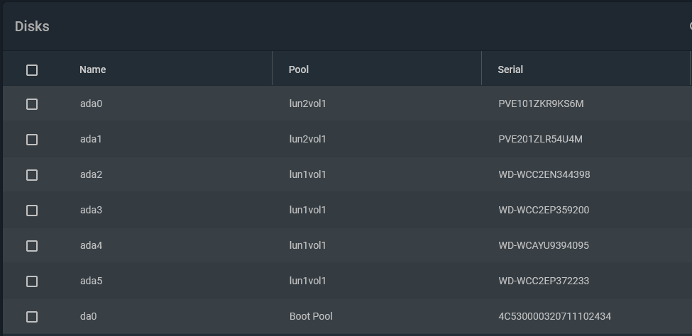

P4#0383
Dec 21, 2019
39
Thank you again for your feedback.
I understand your position and I get it can become confusing.
My hardware configuration is basic and running on some old hardware I had to spare.
Mobo: H61H2-AM3 V.1.0 15-EQ1-011000

All drives are reported as ada (please see attached picture(s)). I am still perplex FreeNAS was failing to mount a stripe or mirror volume.
Given this was driving to deep and I didn't feel like deeping into the code, I just replaced the RAID card with a basic expansion SATA card.
Still I was able to find the answer by replacing the Syba PCI with an Adaptec RoHS PCIx card and now I can use the drives at my discretion.
Thnx for all your assist!!!!
