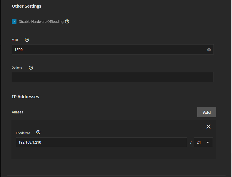

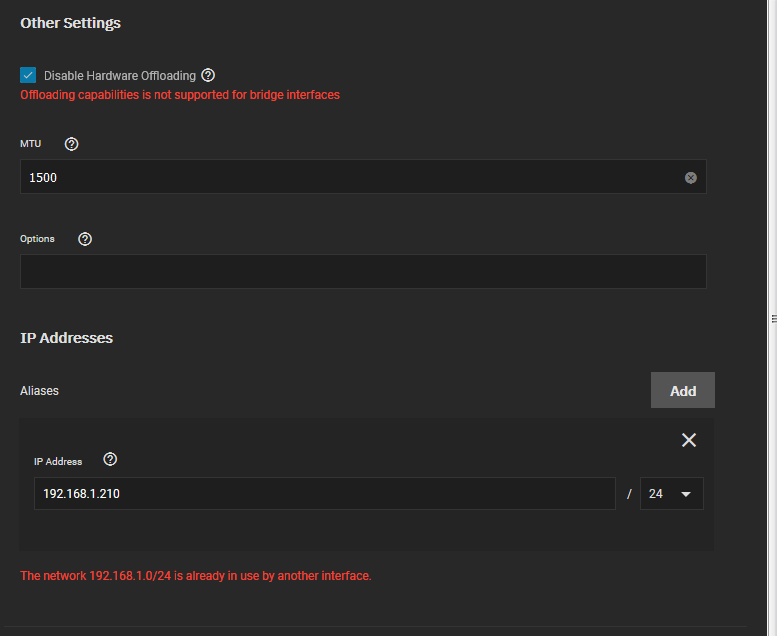

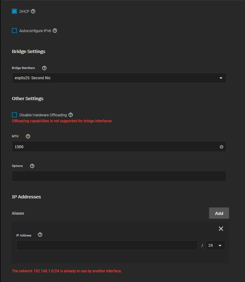

A bump. From what I've read I need to create a "bridge" interface to see the local network from the VM? I took screenshots of myself trying to get that working but with no success. Would really love some pointers getting this working. From my lack of experience in networking and virtual machines, I'm probably not finding the right keywords to find the solutions online. Could I really be the one of three out of thousands of users that wants to do this? Thanks for any help!

And update. I got it to work. A reply on Reddit said that Truenas would block a connection to the same subnet. In order to have a second subnet, I installed a second network card in my router, and another one in the Nas. Passed the pci card through. Worked right away. Now I can finally finished this project I started 11 years ago.

Just in case anyone else stumbles across this thread with the same problem:
I have the same issue and putting in a second NIC does indeed solve the problem, but I think it does not have anything to do with different subnets.
I assume all your NICs are receiving IPs from the same DHCP, thus being put in the same subnet anyway. The problem as I understand it is, that the KVM virtualization of truenas SCALE works completely differently (i.e. blocking traffic between host and guest) from the bhyve virtualization in truenas CORE where this works out of the box, having only one NIC. Details I found in this thread: https://www.truenas.com/community/t...-ping-freenas-scale-host-or-vice-versa.88487/
