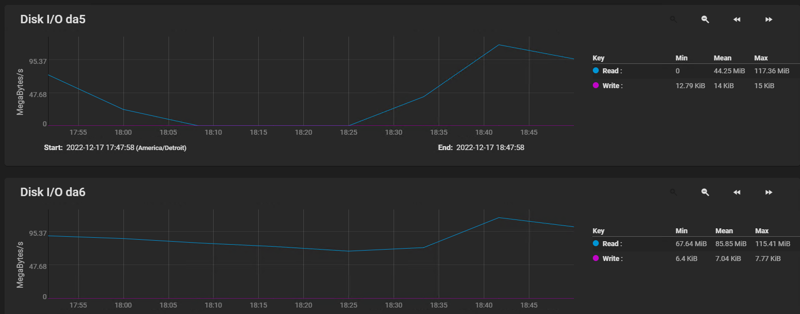

one vdev you should be safe, once you have more than one and you scrub you will see times the whole pool is reduced to the performance of one vdev(a mirror or raidz vdev). I have observed this where a pool was scrubbing at 3 or 5 gigabytes per second and then for 15 minutes the scrub slows down to 500 megabytes per second becauase it is reading blocks from just one vdev.
The only way to fix this is to re-balance the blocks on the vdev. I believe there is no way to re-balance at this time. I have tried to use identical settings and fill my pool to 79% and then scrub it. It might be the worst case is filling teh disk with DD random data and moving vmware vmdk files to a TrueNAS iSCSI/NFS/Fiber Channel store. :-(
Here is my sad results(15 minutes of IO only on the first vdev):
