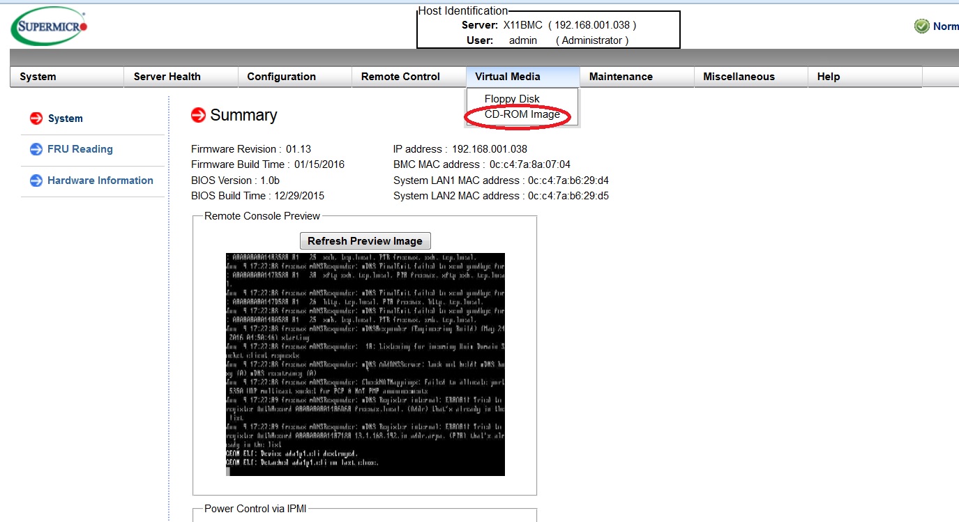

That is a good idea, the board actually has 6 ports, so i can add 2 more and install free nas to them
But without a dvd or USB Boot support, what can I install from?
Virtual media method via IPMI
