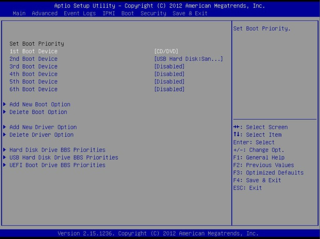

I know it sounds crazy... but sometimes it seems like BIOS settings just don't 'take' and have to be re-entered. So you might want to try double-checking them.
Can you post a screenshot of your BIOS boot settings? Like this:

I will send the bios screen later today

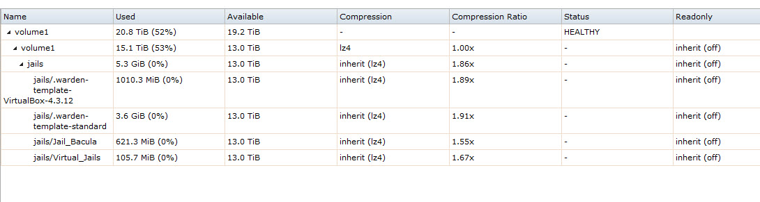

The one question, after it is back up, i can restore config, but how do I import the pool, or if I restore config first, and reboot, won't the pool come back automagically?
OK, I see it, storage, import volume
But again, if i reload config, and reboot, it will just import it and all the jails, won't it? See my volume list below
