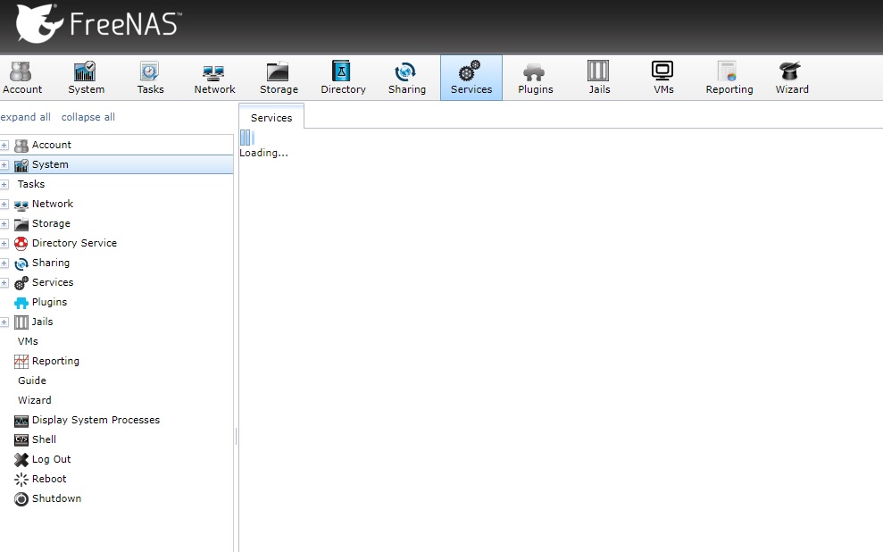

Hi Support team,
I'm trying to implement FreeNAS OS in my network and after installing successfully i can able to login but some services are not running properly. In related to this bug i created a ticket #29022. In this they said that it is due to incompatible NIC, and they suggest me to check with other NIC. So could you please provide list of NIC Ethernet that support FreeNAS OS?
My motherboard model is - Asus H110M-D
Another machine is - Compaq SG3440IL
Prod # KT478AA#ACJ
Can you provide supporting NIC for above models?
Regards,
Vipin.PV
