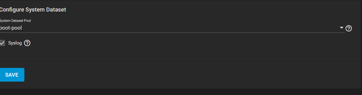

Hello,
at the moment i run TrueNAS as VM; i have main pool encrypted (pass protected) and its created from the drives which are pass through to the VM.
What is the best practice regarding the System Dataset location ; i read manual and its not good idea to put it to the boot-pool as during the backup there are issues etc.
Is it good idea to put it back to my main pool - which is encrypted ; ie each time i boot TrueNAS i have to first provide pass to unlock that pool.
Thanks!
Why would the System Dataset being located on the boot-pool interfere with your backups? Can you link the manual where it says that?
You won't be able to. TrueNAS prevents placing the System Dataset on a pool in which the top-level root dataset is encrypted and protected with a passphrase.
