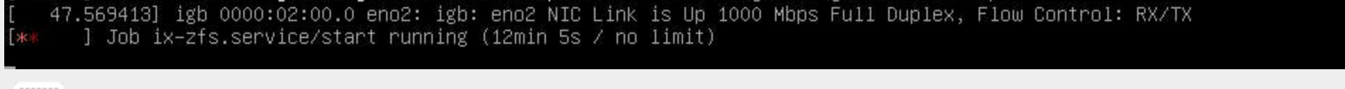

Hello,
The server has been stable for the past couples of weeks but today happened something very weird. All of a sudden the server rebooted by itself. It happened when the kids were watching Plex and I was updating TrueNAS integration + adding my Hue Bridge on Home Assistant.
Now every time I reboot the server I'm getting this message in the iDRAC console;
After 15 minutes it's booting to TrueNAS, unfortunately some things seems to have broke since that reboot.
Thank you!

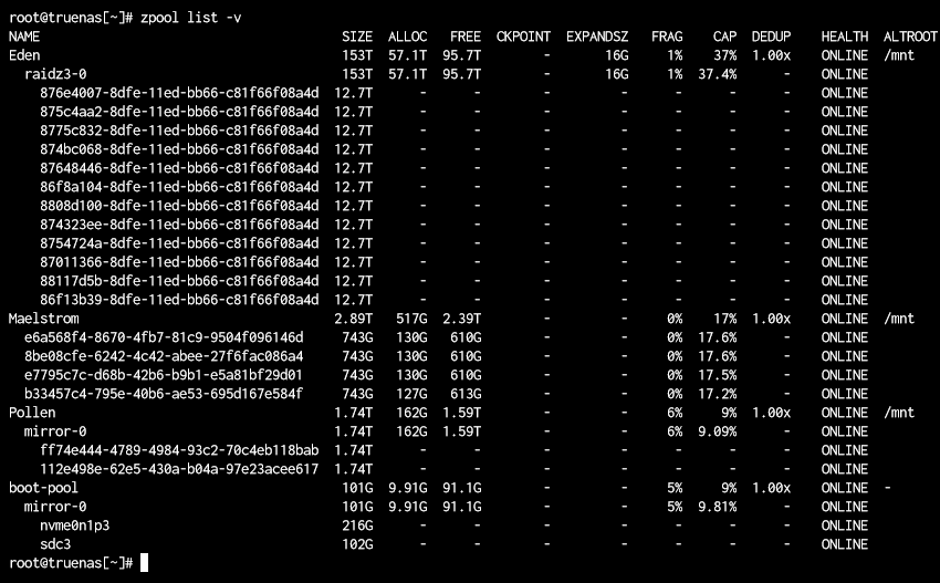

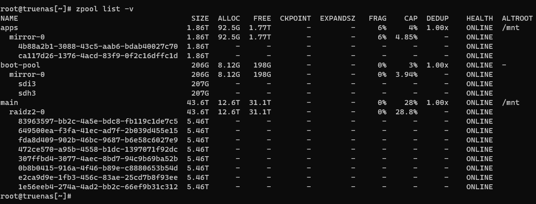

NickF
Jun 12, 2014
763
IIRC if I remember correctly (I just looked at this in another thread) all the service in question here does is import the pool at startup.
I’m not sure what might cause the delay in the pool import process for you, it would be helpful to look at your pool layout.
What does
zpool list -v
Say?
It may be helpful to know what version of TN you first created your pool
And whether or not you have upgraded your pool
mrfr34ky
Apr 12, 2023
12
What does
zpool list -v
Say?
It may be helpful to know what version of TN you first created your pool: I think 22.12.2
And whether or not you have upgraded your pool: No
CheeryFlame
Nov 21, 2022
184
NickF
Jun 12, 2014
763
What's interesting is that you are both experiencing the problem and you are both using mirrored boot pools. It may be worth testing to see if the problem exists if you remove one of the boot drives.
If it does not, you have a pretty good case for there being a bug.
