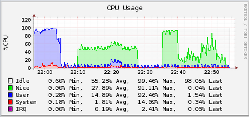

I have a very similar setup. See my signature for specs. I run Sab/Couch/Sick and plex.
I was doing some testing with transcoding on my setup.
Comparing mediabrowser to plex.
Single stream to a chromecast.
22:10 to 22:25 is media browser
22:35 to 22:55 is plex
the blue hump at 22:20 is Sab doing something.
The video being transcoded was purposely chosen to have high bitrate. Exact specs are:
Video Resolution 1080p
Duration 2:10:32
Bitrate 27767 kbps
Width 1920
Height 1080
Aspect Ratio 1.78
Container MKV
Video Frame Rate 24p
