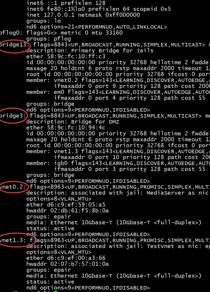

The vnetx.y interfaces are created automatically. What you need to do is create one bridge interface for every physical or VLAN that will connect jails.
vnetx.y are in fact renamed epair interfaces. An epair is a virtual patch cable that behaves like an ethernet inside the jail and like a switch port outside the jail. The artefacts you see outside are bridged with the suitable physical/VLAN to connect the jail to the latter. You will end up with as many epair/vnet as you have jails. Or even more - a jail can have two or more interfaces.
Don't worry, the system easily supports thousands of them.

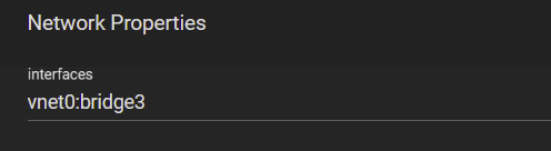

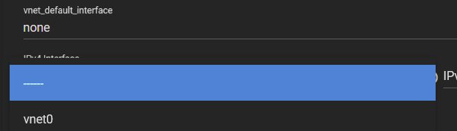

Thanks Patrick But that is not what I observed. In the network configuration it wanted me to specify the VNET and bridge. When the new Jail is created it does not give me an option to input anything other than Vnet0 here

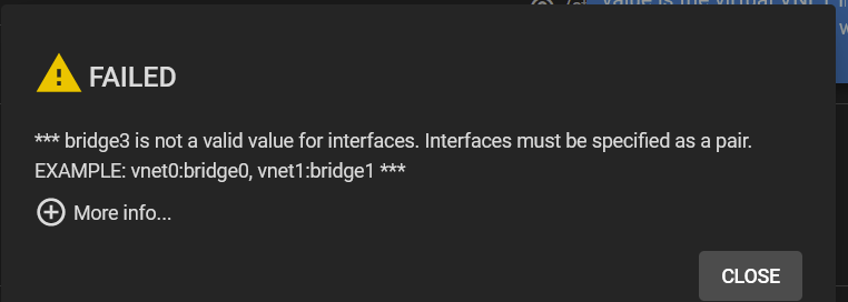

In the networking configuration I can only specify VNET:Bridge (if I put bridge there alone it creates and error)

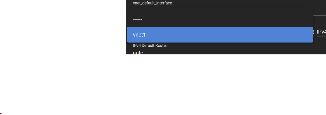

If I put in VNET0:Bridge3 the jail is created but it is not able to ping anywhere else outside the netowrk. So to make it work I had to put in VNET1:Bridge3 here, then save the Jail and then go back to the basic properties and then select Vnet1 here
After that everything seems to work. I still need to work on VLANs in this new VNET stack so before that I wanted to make sure I am following the accepted configuration

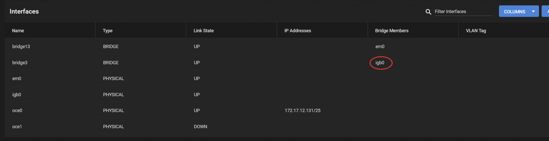

These are the Interface Settings. The interface that I am currently working with is igb0
em0 is already associated with other VNET Jails and the Oce0 for non VNET jails and holds the default route.

I am dedicating the NIC to the specific network segment & Jail. So the traffic is untagged.
