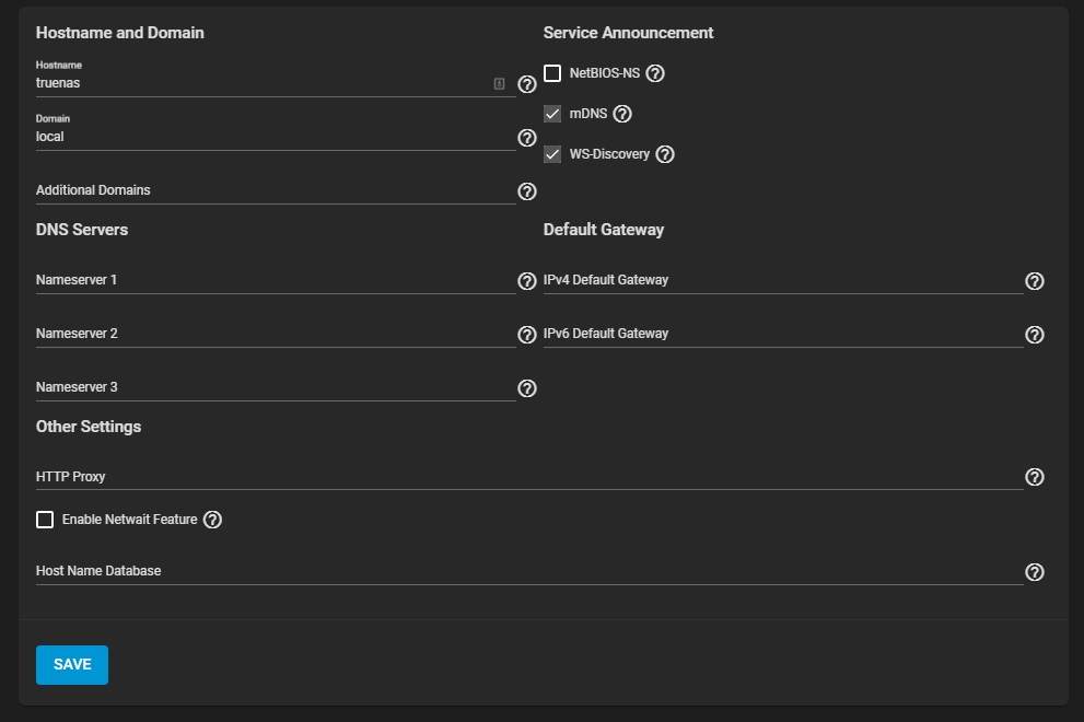

I did try to ping google and it didn't work .. So I was looking around the network screens and found this page .. I am going to assume that more of this screen needs to be filled out ..
All I did was go into the network interfaces and set it for static ip address instead of dhcp ..
Also not sure what you mean when you say ssh to login .. I am just going to the ip address of the TrueNas box in chrome and then logging in that way ..
Like I said I am new and dont know what I am doing .. yet ..

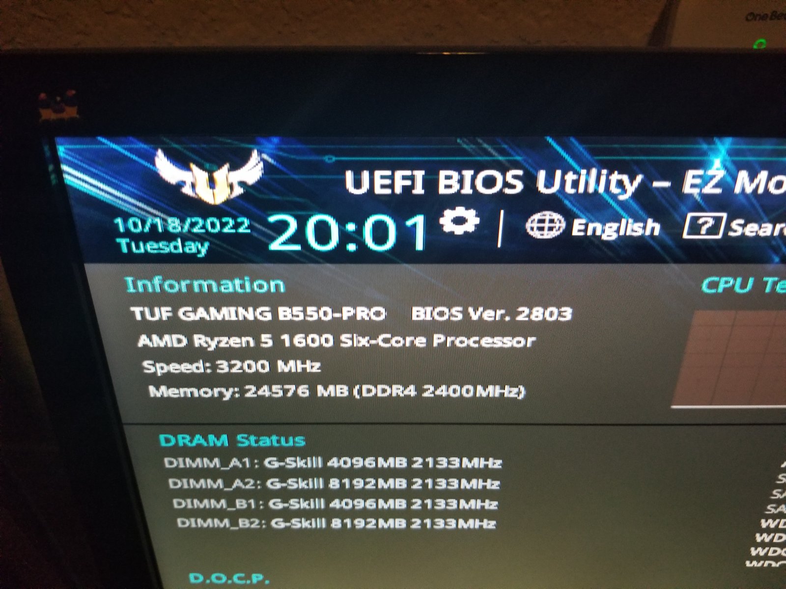

Ok Bios is now looks like

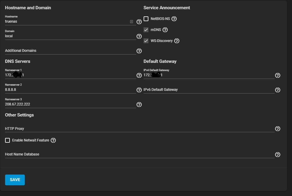

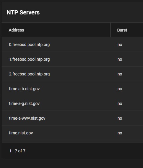

You need to set a default gateway and DNS servers for NTP to finally work.
StarTrek133
Sep 5, 2022
112
Yep I thought so .. So I did the following ..
