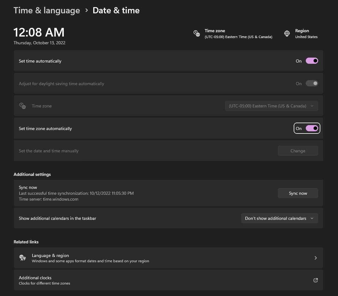

Here is a pic of the windows time and date screen ..

Patrick M. Hausen
Nov 25, 2013
7,776
The VM settings in TrueNAS, not the Windows settings,

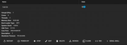

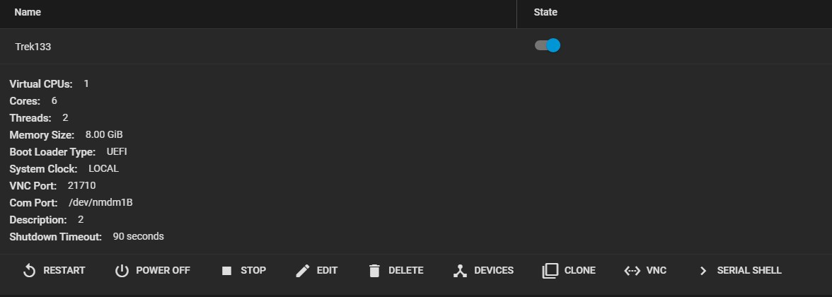

Sorry .. thought you meant the VM .. here is what I currently have ..
maybe I need to check the system clock
Patrick M. Hausen
Nov 25, 2013
7,776
Set the BIOS clock of the TrueNAS machine to UTC. Check time server and time zone settings of TrueNAS. Keep the VM clock set to local. That should fix any issues with wrong time at startup of the VM. Then enable network time synchronisation inside the VM.

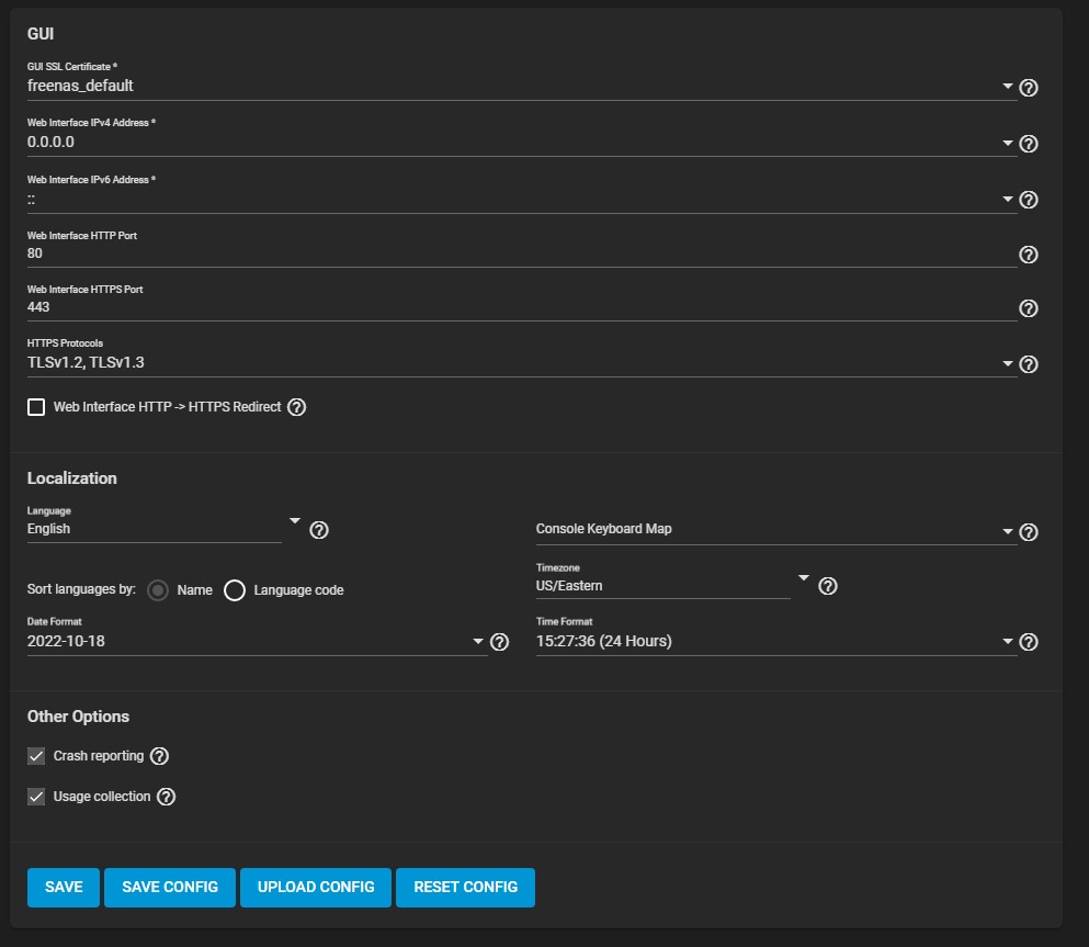

Hey Patrick,
I am going to assume when you say "Set the BIOS clock of the TrueNAS machine to UTC" you mean inside the Bios of the motherboard ?

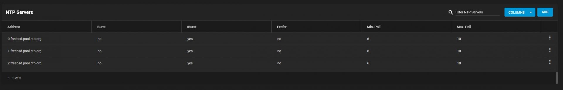

Here is a screen shoot of the NTP Servers , I hope that is the time settings for the TrueNas box ..
I also found the "timezone" settings finally in TrueNas and it was set wrong .. I changed that to US/East which is where I am ..
So I hope that will fix the issue ..

Patrick M. Hausen
Nov 25, 2013
7,776
Yes, of course. I am speaking of the hardware clock of your machine. Unix systems run their clock in UTC, always. And convert to and from local time for output/input of dates. It's a multi user system - so multiple users can each have their own timezone settings.
Windows assumes a single user PC - even for the server systems for historical reasons. So the hardware clock should be set to "wall time". That concerns the settings for the emulated hardware (VM settings in TrueNAS) and then the timezone settings inside Windows.

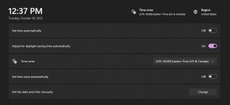

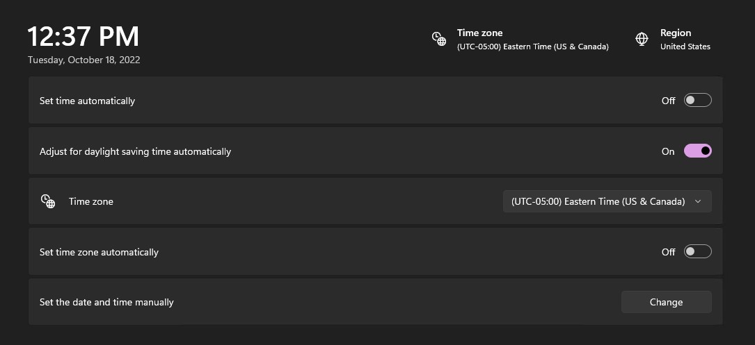

Yes Spuky .. here is a pic of what the current settings are in the VM ..
One thing I think might be happening but I am not sure as I am not a Linux person or Truenas for that matter .. I found some shell commands and when I run them they all error out .. So maybe the NTP Servers are not running or working correctly ..

Patrick M. Hausen
Nov 25, 2013
7,776
The BIOS and VM configuration settings I advised you to use are relevant for boot time (first of TrueNAS, then of your VM) only. Time tends to drift inside VMs so you probably must use NTP.

Hey Patrick ..
I rebooted the VM and the current time is 10:11AM .. but here on the east coast its 2:10pm .. it always seems to be 4 hours off ..
The VM settings say "System Clock: LOCAL"
As for the Bios I changed the time so it was correct .. As for Truenas I don't know where or how to check the time on it .. I just cant seem to find it ..

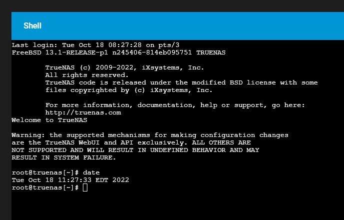

Patrick M. Hausen
Nov 25, 2013
7,776
Type date into a shell.
StarTrek133
Sep 5, 2022
112
Thanks Patrick ..
So it looks like its the Truenas box as the time is wrong on it ..
