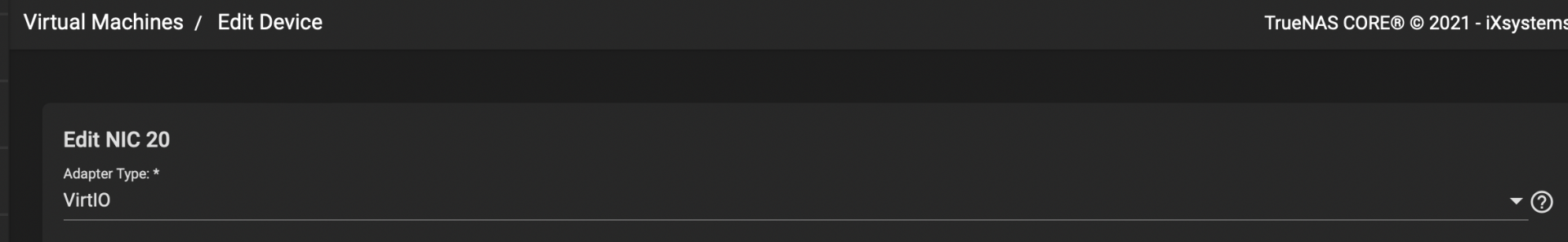

On CORE, you need to use the VirtIO NIC, download the stable VirtIO Windows ISO, and install the drivers

Agreed, once you have Windows running, enable RDP and use one of many RDP clients to access Windows guest. The Microsoft RDP clients are decent.
@Evertb1
Had same issues as reported by @Curt1s2aurus, but once I switched to VirtIO NIC and drivers, Windows guest is acceptable for occasional use.
I will try this when I get home. I used a dedicated Ethernet port instead of the virtual one. Hopefully it gets better fps on the Microsoft rdp too. I never thought about trying that.
