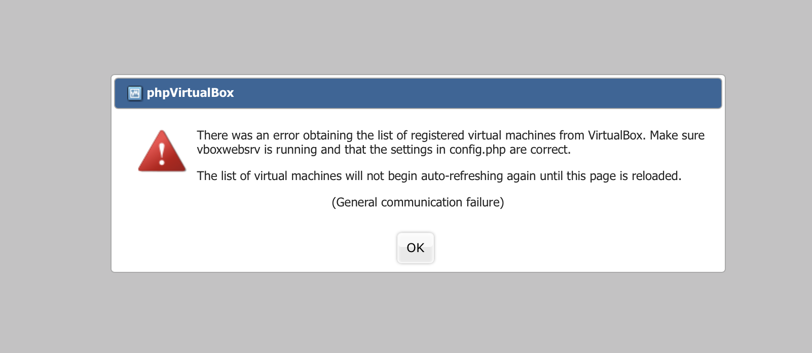

after getting virtual box working I now have this error? anyone seen it before? View attachment 16085
I get the same error without fail after varying amounts of time with I am logged into the virutalbox web interface. Sometimes it happens right away, sometime it takes 10-15 minutes, but it always occurs. Refreshing the page reloads the web interface. Don't know how to fix the issue though. Does not seem to affect functionality in anyway.
ArgaWoW
Jul 4, 2015
444
Have you done all the steps from the first post of this treat?

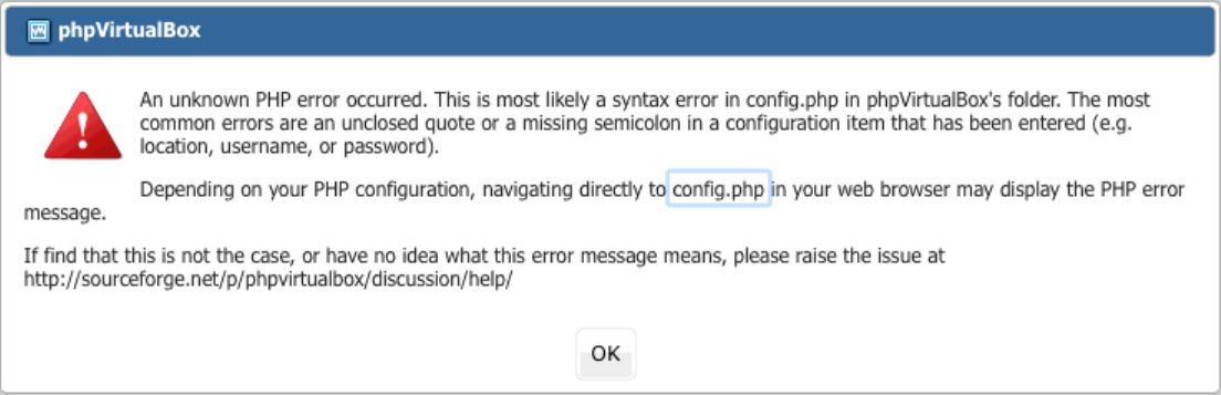

Has anyone seen this error before? I followed all steps but can't seem to get past this error. I double checked the config.php file but I couldn't see any issues. I'm hoping this is an easy fix. Any help is greatly appreciated!

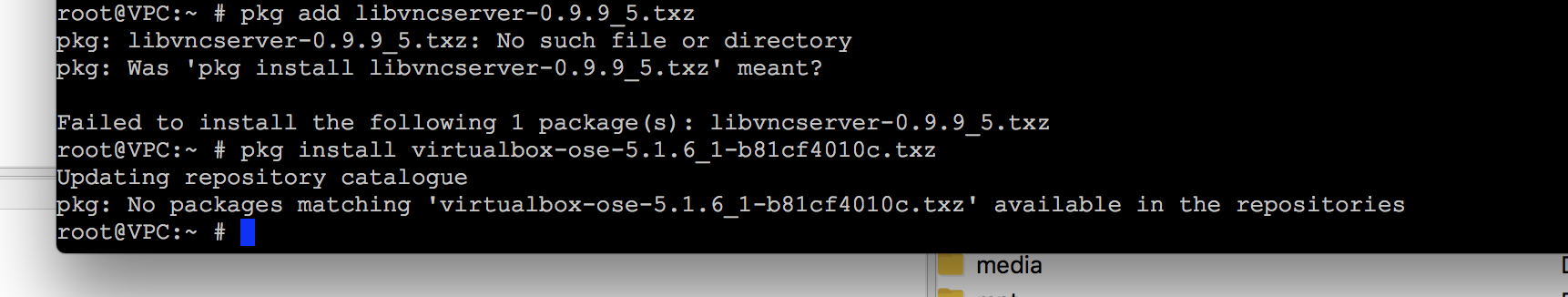

hi, virtualbox can't be installed regarding the how-to as "quarterly" release is now "virtualbox-ose-5.1.12_1.txz" which not work and 5.1.6 version is not available anymore... :-(
