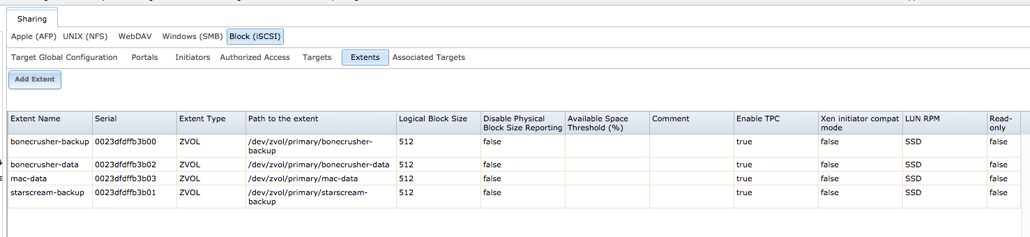

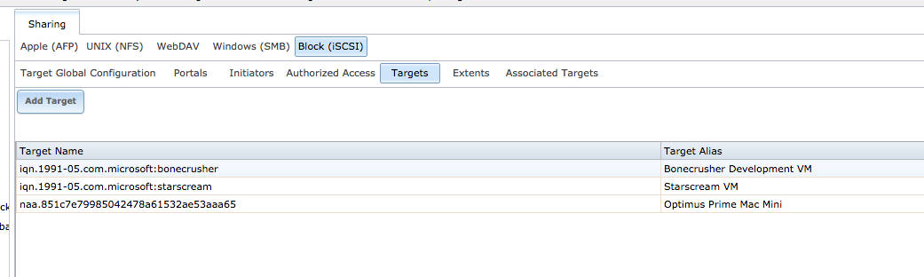

I'm running iSCSI to share multiple iSCSI targets. Since I'm new to iSCSI I'm concerned I have the LUN IDs or other settings setup incorrectly.
Here's how I'm connecting:
  • I'm running globalSAN Initiator on the connecting Mac Mini (mac-data).
  • I'm running the built-in iSCSI Initiator in Windows 2012 R2 running in Parallels VM on Mac Mini (starscream-backup)
  • I'm running the built-in iSCSI Initiator in Windows 8.1 in Parallels VM on Mac Pro (bonecrusher-data and bonecrusher-backup)
Should there be a unique LUN ID for each Target-Extent combination?
Or, should there be a unique LUN ID for each Target?
Or, is there some other rule one should be following when assigning LUN IDs?
Let me know if you need more setup information. Thank you.
