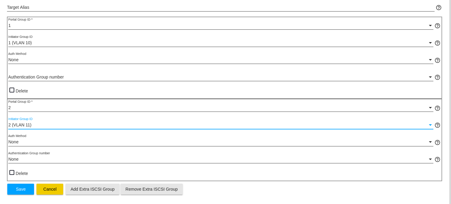

Problem: I am unable to add a second iSCSI initiator to any target.
I have two ESXi servers that I am trying to connect to my FreeNAS through 2 different switches on different VLAN's and networks.
I am able to connect the first ESX server to all of the targets and LUNs without issue. But I am unable to connect my second ESX server.
The problem that I have is when I try and "Add Extra ISCSI Group" to my one of my targets it does not add, it replaces it. Because of this I have no way of connecting ESX2 to to a a target / LUN because initiator 2 is cannot be attached to a target.
Steps:

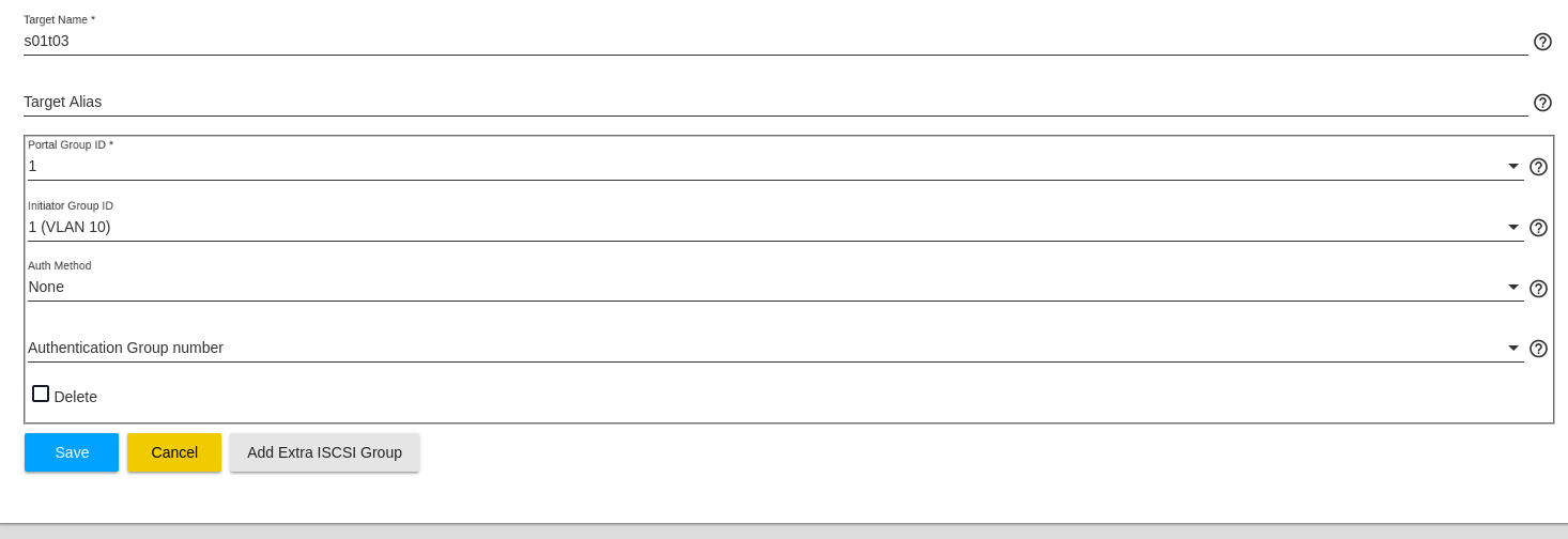

1. Edit target s01t03
	a. Portal Group ID is already set to 1
	b. Initiator Group ID is already set to 1
2. Click Add Extra ISCSI Group
3. Select Portal Group ID 2
4. Select Initiator Group ID 2
5. Save

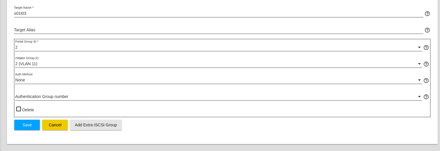

Then when I go in back in to edit s01t03, there is only one Portal Group (2) and one Initiator Group (2). This happens on all of my targets. Oct14-10:29:35.png
Is there another way for me to add another Portal and Initiator Group to a target? Is this just a bug in the web interface?
I have tested this on Windows in Firefox and Chrome, along with Linux in Firefox and Chrome.
