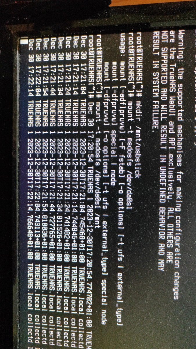

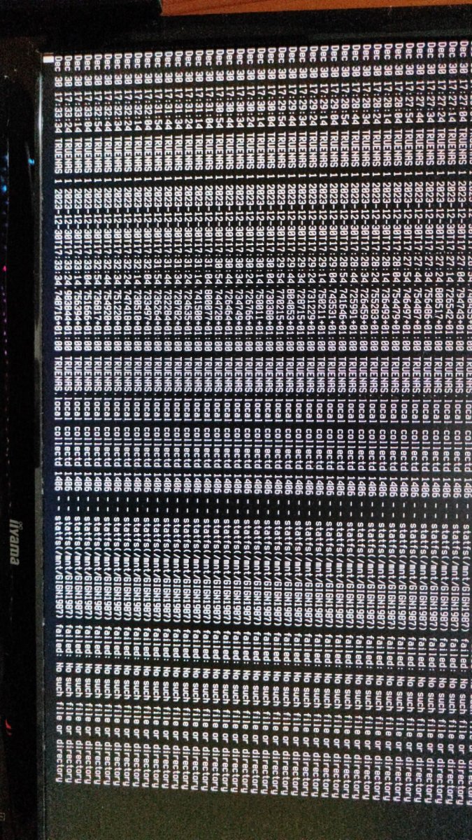

I was using TrueNAS Core V12. Did update to V13 and i cannot mnout usbstick to install network driver for Realtek RTL8125B network card. Followed this guide:
FreeNAS on Odroid H2+ – RTL8125B driver installation
I got error on pictures
Any advice how to install network driver ? I do not have currently working connection on the NAS system.

TrueNAS is not an OS release, it is firmware that does not support adding network or disk controller drivers.
I understand the desire to use very low end hardware. But, TrueNAS & ZFS were designed for Enterprise Data Center usage. While many SOHO and consumer computers will work fine, not all network or disk controllers work. Further, even if a network chip worked before, if that NIC was un-supported, that means iX may remove it's un-supported driver at any time.
It is possible that TrueNAS SCALE might have some support built in for your network chip.

The linked blogpost references FreeNAS 11.3 which is no longer supported.
If you want to enable the built-in Realtek driver, please note that there is a potential data-loss bug with iSCSI with this driver.
Please use the instructions from here to use the TrueNAS CLI to enable it
https://www.truenas.com/community/t...d-h3-rtl8125b-2-5gbps-nic.105325/#post-724619
root@truenas[~]# cli
> system
system> tunable
system tunable> create var=if_re_load value=YES type=LOADER enabled=true
system tunable> create var=if_re_name value="/boot/modules/if_re.ko" type=LOADER enabled=true
system tunable>
Ctrl+D to exit, then type exit again, and use the console menu to reboot your system.
