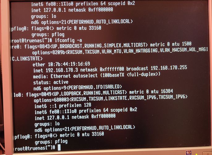

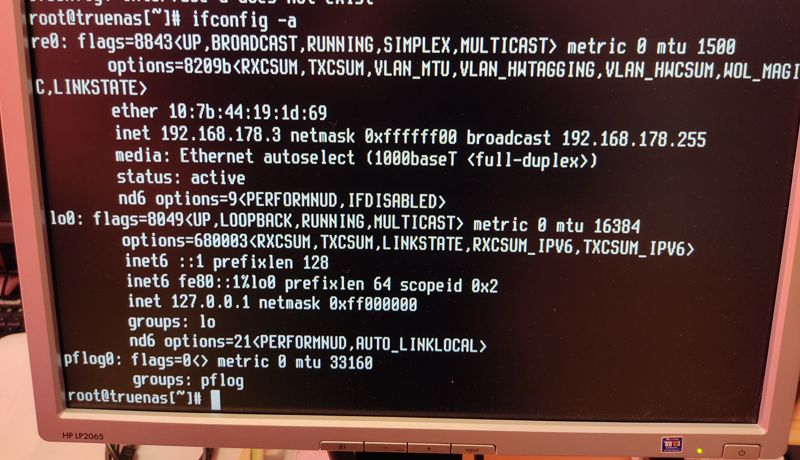

Hi everyone,
I recently upgraded my homelab server from TrueNas 12 to 13. I am using the server as a backup to sync a SynologyNAS over TrueNas' CloudSync functionality via SFTP. This has worked well in v12. Now in v13, my file transfer starts out great, but after a few minutes, the network connection speed drops from 1000 to 100 BaseT while running. Curiously, this speed reduction persists over multiple reboots. I only get GBit back when I unplug the machine and then power it on again. What could be the reason and how can I fix it?
The common suggestion in this forum seems to be bad cables. Since I did not touch the cables between the upgrade and the other hardware did not change either, I doubt that's it.
Setup: H81M-C board with Realtek RTL8111G going into a Netgear GS116 switch connected to a FritzBox (Router) and a Synology DS 620 (NAS I want to back up).

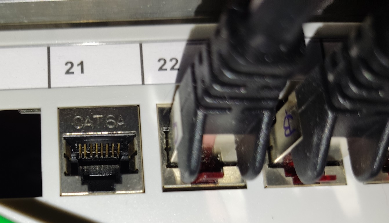

Arwen
May 17, 2014
3,611
Okay, great.
As for your Port 21, the 2nd & 3rd from the right do look a little wonky. But, I can not be sure. And research into which those are in relation to your network path would have to be done to figure out if they are part of the 1Gbps copper path.
Actually thinking about it, the 3rd from the left & 3rd from the right form part of the 10/100Mbps path. And it is either the far 2 right or far 2 left that make up the other pair for 10/100Mbps. But, this is dependent on your layout.
