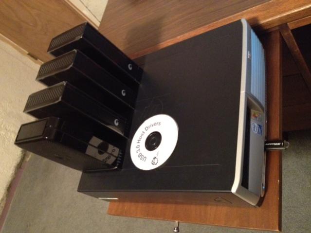

I have an HP small form factor dc7700 computer (Specs here: http://www.retrevo.com/search?q=HP+dc7700+SFF&rt=sp&modelid=3167477) that I want to use as my NAS box.
I have 4 Seagate GoFlex Desk 2TB external hard drives that are USB 3.0 speed. The dc7700 is only capable of USB 2.0. See where I'm going?

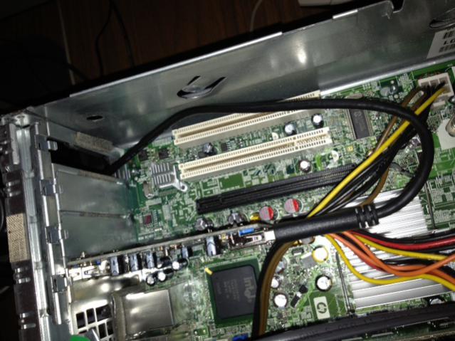

I bought a SIIG DP USB 3.0 4-Port PCIe i/e card (http://www.siig.com/it-products/usb/adapters/pcie/dp-usb-3-0-4-port-pcie-i-e.html) and put it in the PCI express slot. The card has 3 ports on the back and 1 port internally.
I removed a metal plate from one of the unused PCI slots and ran the USB cable from the cards inside port thru the hole to it's 2TB HDD. I obviously connected the other 3 2TB HDD's to the ports on the back of the machine.
I installed FreeNAS 8.0.3 onto a Patriot SUPERSONIC PULSE 4 GB Flash drive which is also USB 3.0 but I am out of 3.0 ports at the moment so I plugged it into a port off of the front.
