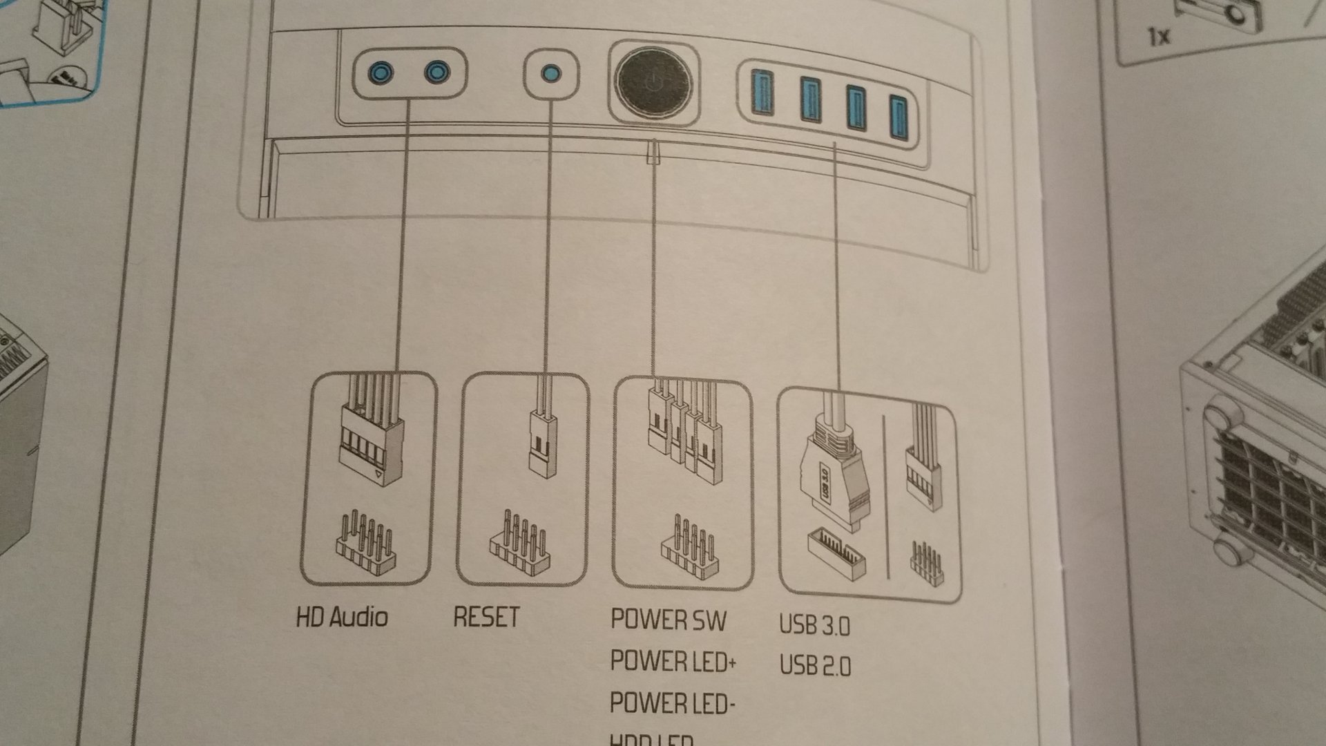

I am in the process of building my server. I have a Fractal Define R5 case. It has 2 USB 2.0 and 2 USB 3.0 ports on top of the case. For wiring it as a USB 2.0 cable 4 pin and and USB 3.0 cable that I don't recognize. The 3.0 cable fits onto the motherboard (Supermicro X10SRA-f) I do not see a slot on the motherboard for the 4 pin USB 2.0 cable. Is there a chance that the cable I don't recognize will actually work for both the 3.0 and 2.0 USB ports. The case manual isn't clear about it. I wouldn't worry too much about it as it will sit in a closet but I read the Freenas doesn't like USB 3.0 very much.

The USB 3.0 header on the MB should have the USB 2.0 signals too (it's the case on the X10SL7-F anyway) so look in the R5 manual to see if it has the right cabling (it should, I would be very surprised otherwise) :)

Yeah, I have looked at the Fractal Design Design R5 manual. Its just not very clear. There are definitly two sets of cables for the USB 3.0 and 2.0 connections. Its just not clear if the 3.0 cable will control both of the headers

oh, I've just checked. that is a workstation board and usb3 only. also there is only 1 usb3 header onboard.

You can just disable any usb3 features and use the ports as usb2.

@marbus90: but you said the MB header is USB 3.0 only?
@OP: you know what? just try to connect the USB 3.0 connector and use it as USB 2.0, if it works it's great, if not there is no risks to fry something so no worries ;)
