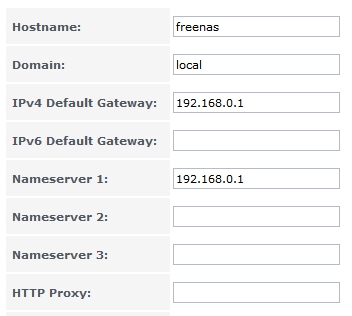

Do you mean this?
My router is on 192.168.0.1
D
dlavigne
Guest
Yes. Can you resolve a name (eg ping google.com? If not, try using 8.8.8.8 as the nameserver.

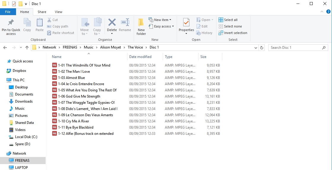

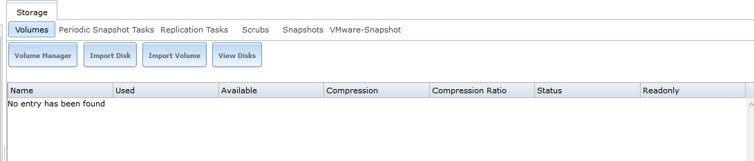

Looking around the control panel I have found other errors. eg, there are 'no discs' on the freenas
but I can access the discs from the computer without any problem
What the *beep* has happened?

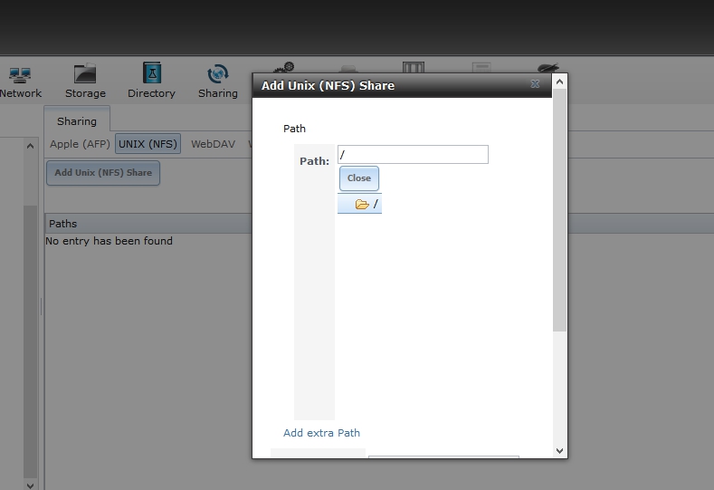

... but now I can't access files on the freenas server, nor can I check/adjust the sharing settings. Reboot of the server makes no difference. I have also manually updated, with no difference noted.
