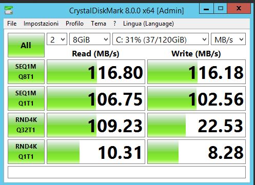

result with sync = default

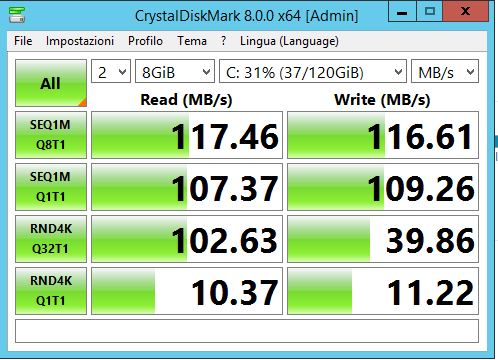

result with sync = off

Those results look essentially the same to me.
Much as I don't agree that the tool you're using is a good measure of any real-world performance, what it does indicate is that you're not doing any sync writes with whatever access method you're using for the test.

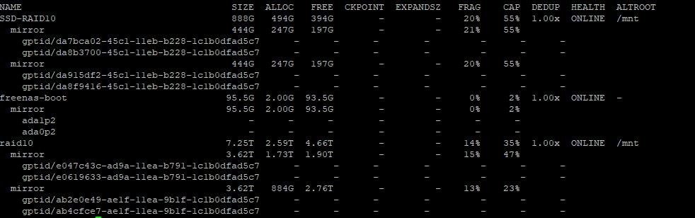

You don't mention anywhere what your pool layout is... maybe it would help to show zpool list -v
A RAIDZ2 pool of 4 SSDs would be a bad thing if you want IOPS.

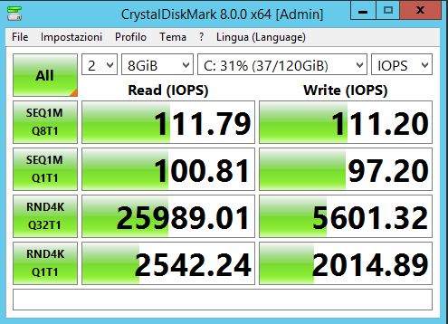

My simple advice it to read up on how Crystal Disk Mark tests, I think you may be confused at what those results mean. Do the test again and this time instead of looking at MB/s, look at IOPS. Also your drives are not speed demons but they do have high IOPS ratings and very long life for write endurance. Also the pool layout is a factor as @sretalla commented.

thank for both your answer @sretalla and @joeschmuck
i post the test with IOPS,
the problem is, I don't see any difference during the use of the server, my guys in office say that nothing changed..
CPU is also a bottleneck 'cause touch 100% too many times and I'm trying to understand if this is the best we can obtain or there is something wrong

4 x4tb wd red + intel SSD d3-s4610 -480gb SLOG
So from looking at your pool layout, what I can see is that you had a pool of two mirrored pairs (4 disks) with SLOG (and L2ARC, which probably makes no difference in this story).
If that single SLOG SSD was already not the bottleneck (as 45K IOPS probably isn't) in your overall system, then of course nobody notices any difference when you move to a pool layout of mirrored pairs of SSDs with approximately 90K IOPS capacity.
You can't make it seem faster if nobody is demanding more from the disks than before.
