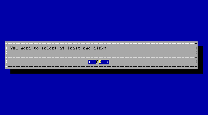

Did you actually choose the stick? I.e., did you press the spacebar to put an asterisk next to it?
You really need different hardware.
Yes..i used the new stick...if new ver11 stick is plugged in system where data hard disks are still connected to..i get message if i want to install freenas..i did choose yes there..so after ram warning message i get third message where i want to install on...hd1 or hd2 or stick...if u choose stick hrre i get message...you have to use at minimum one hard disk...but i am not sure if any of my own data will be overwritten then??? And i do not know which hd 1 or 2 i did use longer time ago for old version of freenas. Why am i asked..i thought freenas can be installed completly on a stick...
15,504

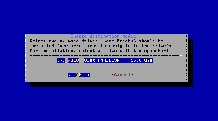

It can. The odds are near 100% that you're doing something wrong. Is this the message you're getting?
If so, you need to do what I said above, and what the installer screen says: PRESS THE SPACE BAR to select the device you want to install onto. It isn't enough to simply pick it with the arrow keys, you need to press the space bar to select the target device so it has an asterisk next to it. It will look like this:

YES thats the screen, the first picture is the one i get first, correct.
ok then i will try to hit space bar next time and choose the usb stick 8 GB the new one as Installation target and
check if that usb stick entry then has a asterix sign.. THX!
