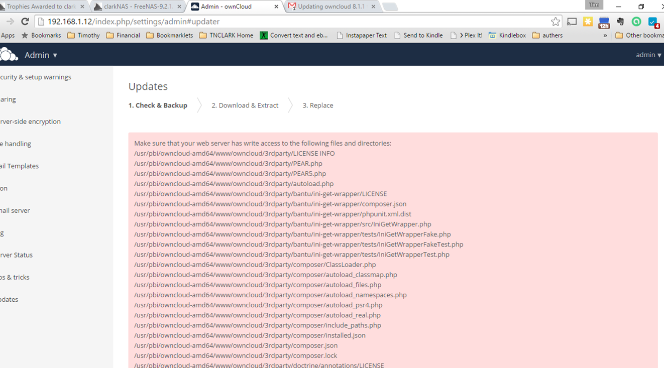

I installed another ownCloud jail, looking to troubleshoot. I went to the update section in the admin profile and selected update there. It does its check and says I need to make sure that I have permissions to the ownCloud directory to be able to install the update. I have tried chmod 777, chmod 755 from both the root of the NAS and root of the ownCloud but have not successfully given the directory the permissions it wants. I also tried adding a "-R" to allow it to be recursive on all the subdirectories but freeNAS does not recognize that command. The official instructions say to repair the install using the command "occ" (ownCloud console" but that application does not seem to exist.

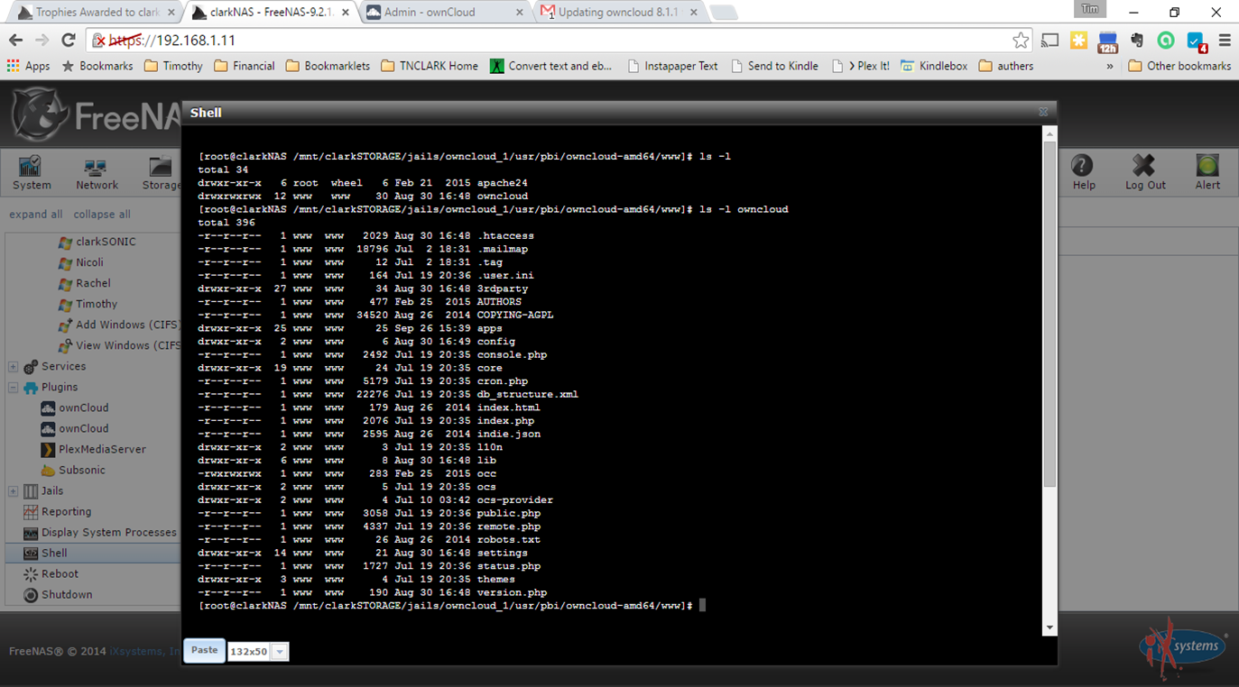

Here are the 2 pics you are looking for. The second is cut off and goes on for several hundred lines. There is a retry button at the end of the error.

Unless you changed the user apache runs as, it owns the directorys it is trying to write to.
Maybe you can ask on the owncloud forums as well
