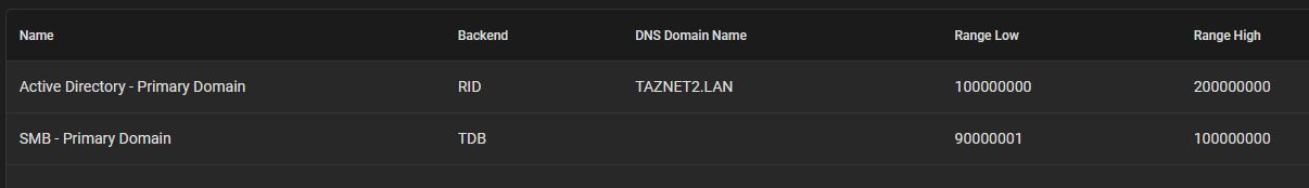

Further reading suggested I run testparm -s. I saw an error
idmap range not specified for domain '*' ERROR: Invalid idmap range for domain *! Server role: ROLE_DOMAIN_MEMBER
I changed the idmap backend type to AUTORID, and after restarting the directory services, getent group showed domain groups.
I looked at my share permissions and they would have to be reset. I tested it on one share and it works. I switched back to RID and getent is back to not showing domain groups and testparm shows the invalid idmap range (which is set to 100000000 - 200000000).
How can I make this run on RID instead of AUTORID?
sgt_jamez
Jul 30, 2021
88
So I was able to fix this problem. Here's how:
I saw on my working machine that the idmap section of the Directory Services had two lines. I added the second line to my troubled machine and after a Directory Services restart, everything was working.
So that's the "how". I still don't know WHY that fixed it. Could someone make sense of this to me?

After putting RC1 on the old machine it still had the issue. And the issue was resolved by adding the SMB line in my previous post.
I had the same issue and this did the trick! Thank you so much for posting this here.
For reference: I upgraded from TrueNAS-SCALE-22.02.0 to TrueNAS-SCALE-22.12.0. I have two servers that are set up near identically as well. One of the servers is still on 22.02.0. I can also confirm (the same as you) that the setting exists in the server that I have yet to update and was missing in the server I have already updated.

We're tracking this bug and will have fix in 22.12.1 (it was a broken migration that deleted an internal idmap entry in some edge cases).
