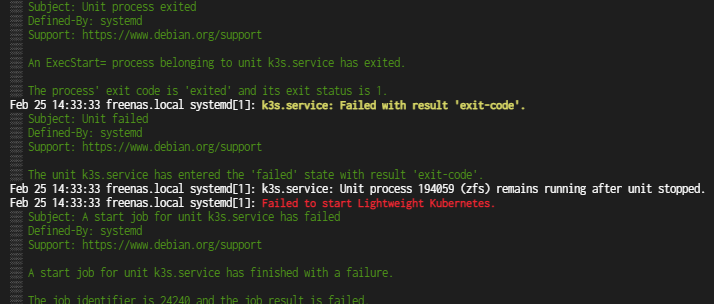

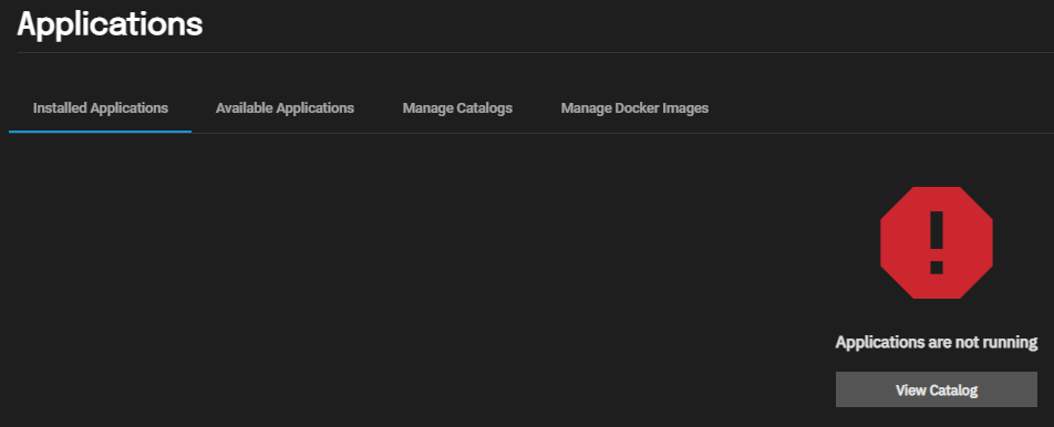

Since update on 23.02.2022 to version 22.02.0 I have issue with Kubernatus where my Apps are not visible and not started:
I tried manual update to 22.12 Master but that didn't solve my issue. Below are errors so maybe someone know what is going on, or I should fresh install it with my configuration??

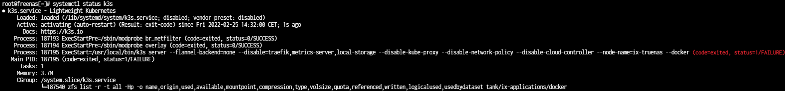

systemctl status k3s
After k3s restart:

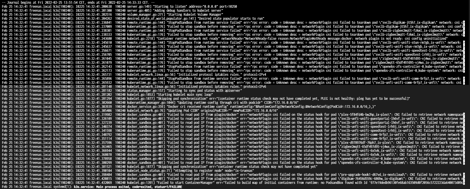

And journalctl -xe logs:
I'm fresh user of TrueNAS Scale, I searched for some qlues and help on google but no solution worked for me. Is there any solution without needed of fresh installation?

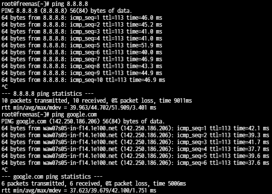

Date and timezone is correct:
Ping and DNs resolver is working fine:
Also I have Home Assistant in VM which is updating fine and is working without an issue. I will post a ticket soon with debug file.

I have backup but restoring it does not work ;/ I think Upon update something goes wrong and in logs I have missing /etc/cni/net.d which is in dump.txt file I attached.

My timezone is correct as mentioned above also DNS is working fine as My Home Assistant VM is working without an issue. Any other clue?? This is very strange as I have missing this file:
Feb 25 15:46:53 freenas.local k3s[517984]: I0225 15:46:53.245957 517984 cni.go:239] "Unable to update cni config" err="no networks found in /etc/cni/net.d"
