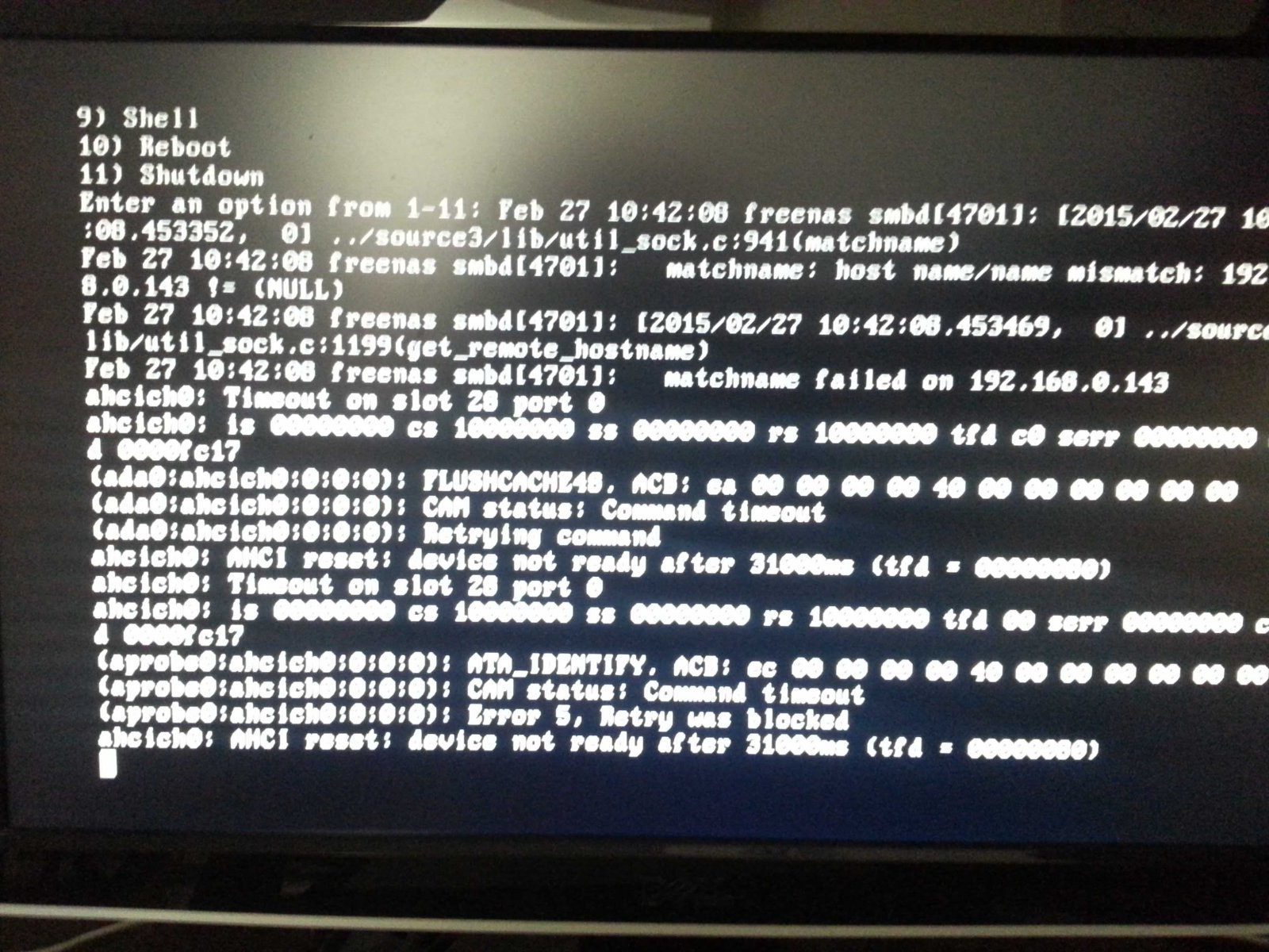

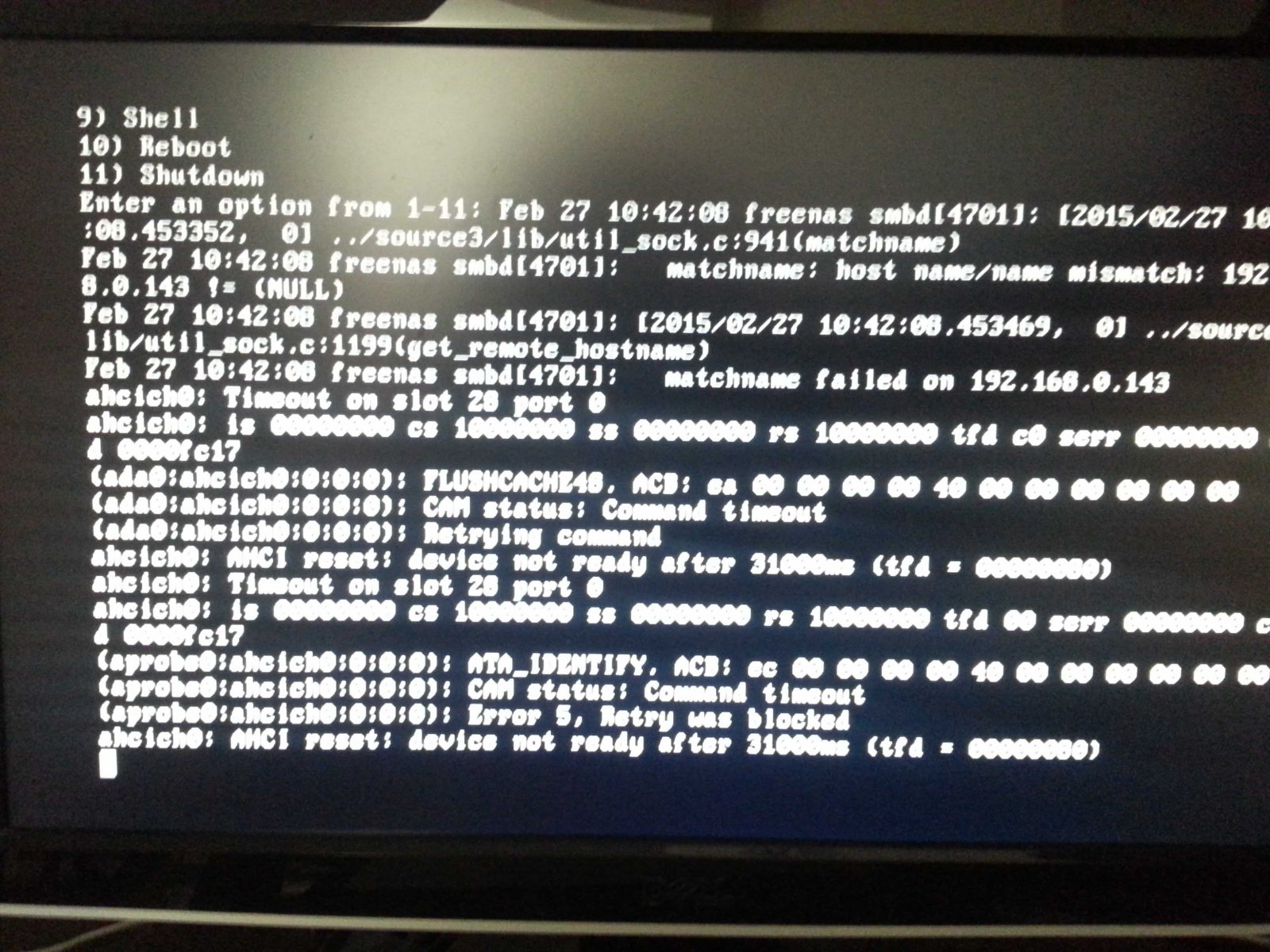

Rut Roh. Bought the new HDD to replace the one that failed last night, with a plan to replace today.
While walking up this morning I got an email that my volume is degraded.
I rebooted since it was showing a bunch of errors and now I get:
freenas smbd[4701]: matchname failed on 192.168.0.143 and a bunch of Timeout on slot 28 port 0
and AHCI reset: device not ready after 31000 ms (tfd = 00000080).
and some other AHCI messages...
Can I safely replace the ada0 that failed?
and more importantly...how do I do that w/o access to the GUI?
Hopefully there is a simple fix to get the GUI functioning for a bit so I can remove/replace.
separate question: where do you guys store pics to post onto this site?
have a pic of the messages..
Or how do I reestablish GUI access?

So what you need to do is disconnect the failed disk and then bootup the system. If you don't know which disk is the bad one you'll have to plug in one disk at a time (so you don't mount the pool) and figure out which disk is the bad disk from smartctl.

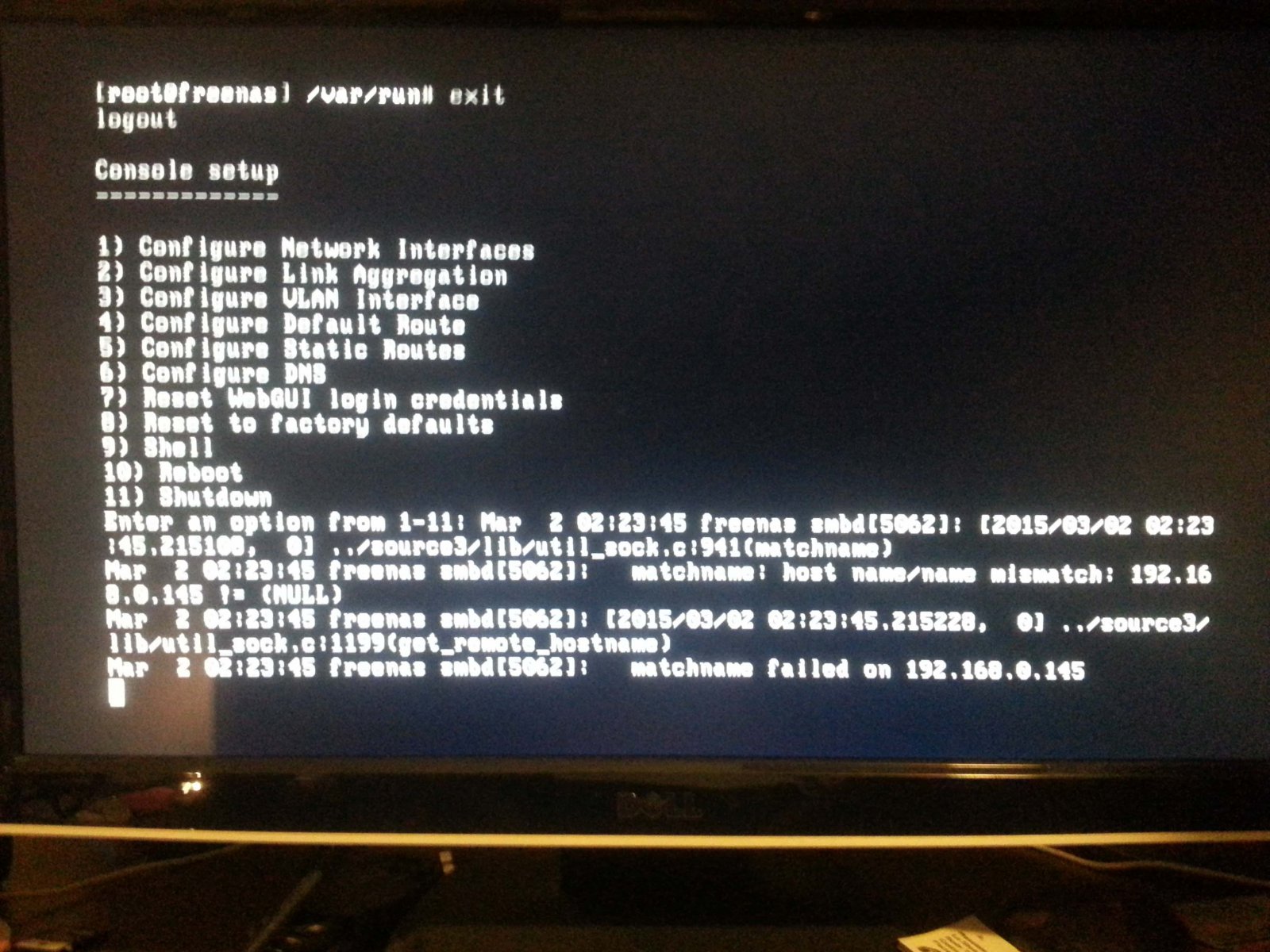

OK. 2 issues now.
I replaced the failed drive (shut down, remove old, replace w/ new, zpool replace command)
Issue 1:
When I do a zpool status, it is still in a degraded state
The Resilvering appears to have stopped (21M 2.5 hours ago...hasn't changed in an hour).
Can I restart the resilvering? Or did I do something wrong?
Issue 2:
Still no GUI IP Address. I can't figure out what the problem is.
At the "Console setup" I get the regular options, but the GUI IP info doesn't even show.

Umm... you are *all* over the map bro! Holy crap!
No clue why the GUI IP isn't showing. If it's supposed to be DHCP it's not getting an address (there's a billion reasons for that, so I can't even guess what it might be).
The name/hostname mismatch means that the hostname connecting to the server and the hostname that matches that IP doesn't match. It's not a big deal and you can simply turn that off unless you feel you need that kind of security (hint: you don't if you don't even understand the error... and that link doesn't instill me with confidence that you understand it).
The WebGUI can be unresponsive for a bajillion reasons. Someone else's issue is likely to be totally different than yours unless there is something *extremely* specific to your exact situation and theirs that is identical.
Hint: His problem is not related to your problem. His sanity check passed and his system actually tried to start nginx while yours falls flat on its face while doing the sanity check. Not related at all except that "it's broken".
No clue why you think you need a new USB stick. You provided no evidence whatsoever to even give a hint that your boot device might be to blame at all. In fact, unless ZFS is claiming lots of corruption in your boot device (which I would expect you to have mentioned) then its probably a safe bet that your USB stick is just fine.
No offense, but it really sounds like you are just throwing everything, including the kitchen sink, at the window to see what will stick. Hint: You're going to spend much more time picking up glass than solving your problems if you want to go that way.
