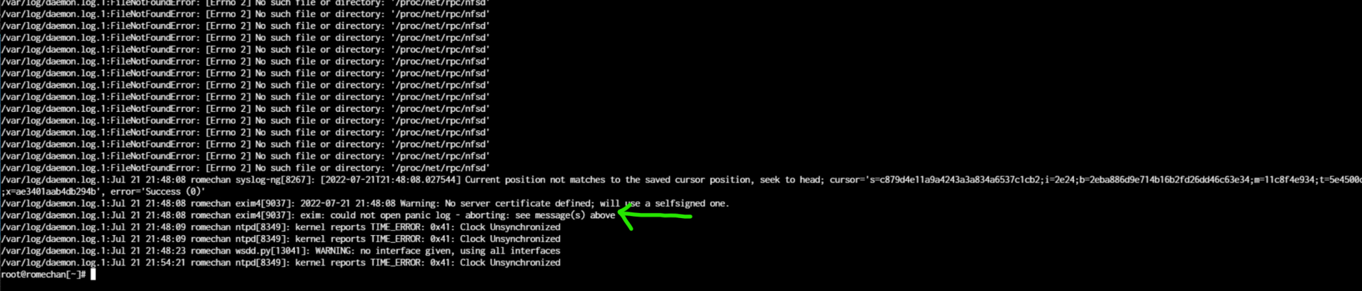

I'll check the Cool n Quiet setting, do Epyc have that too?
Ignasi
Jun 5, 2021
5
Possibly this? ... but not much more information there...
