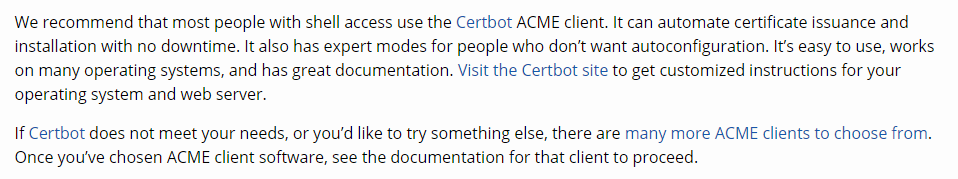

Let's Encrypt is mentioned frequently in forum posts so I head there. I came across the paragraph below.
I recalled seeing something about ACME in the 11.3 release notes. I looked up the UG. I couldn't find the option to create an ACME certificate on my server, so I set up the ACME DNS Authenticator in the hope that the option would somehow magically appear. It didn't. So here I am.

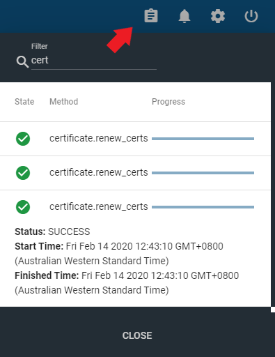

I had no problems setting up an ACME DNS Authenticator. However, it's not clear to me how to tell whether it's working or not.
I wonder? The new task manager (top right corner of the GUI) is displaying certificate renewal tasks maybe from the DNS Authenticator.
