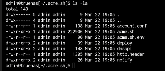

3. Installed acme.sh on my truenas server in /home/admin/.acme.sh according to:
with
curl https://get.acme.sh | sh -s email=nestor@na.na
I made no further configuration.

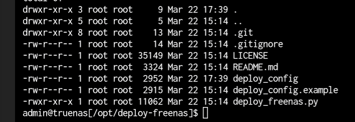

8. configured deploy_config
# Configuration file for deploy_freenas.py
as follows:
[deploy]
# Choose one of the following authentication methods, "api_key" or "password" (comment out the other one).
# Auth via API keys is highly recommended, but is only available from TrueNAS (Core) 12.0 up.
# You can generate a new API key in the web interface under "Settings" (upper right) > "API Keys".
api_key = xxxxxxxxx api key generated in truenas xxxxxxxxxxxxxxxxxxxxxxxxxxxxxxxxxxxxxxxxxxxxxxxxx
# If you are on FreeNAS 11 or lower, set this to your FreeNAS root password
# password = YourSuperSecurePassword#@#$*
# Everything below here is optional
# cert_fqdn specifies the FQDN used for your certificate. Default is your system hostname
cert_fqdn = truenas.lan.internal
# connect_host specifies the hostname the script should attempt to connect to, to deploy the cert.
# Default is localhost (assuming the script is running on your FreeNAS box)
connect_host = tinyca.lan.internal
# verify sets whether the script will attempt to verify the server's certificate with a HTTPS
# connection. Set to true if you're using a HTTPS connection to a remote host. If connect_host
# is set to localhost (or is unset), set to false. Default is false.
# verify = false
# privkey_path is the path to the certificate private key on your system. Default
# assumes you're using acme.sh:
# /root/.acme.sh/cert_fqdn/cert_fqdn.key or /root/.acme.sh/cert_fqdn_ecc/cert_fqdn.key
privkey_path = /home/admin/.acme.sh/truenas.lan.internal_ecc/truenas.lan.internal.key
# fullchain_path is the path to the full chain (leaf cert + intermediate certs)
# on your system. Default assumes you're using acme.sh:
# /root/.acme.sh/cert_fqdn/fullchain.cer or /root/.acme.sh/cert_fqdn_ecc/fullchain.cer
fullchain_path = /home/admin/.acme.sh/tinyca.lan.internal/fullchain.cer
# protocol sets the connection protocol, http or https. Include '://' at the end.
# Default is http
# protocol = https://
# port sets the port to use to connect. Default is 80. If protocol is https,
# this MUST be set to your https port.
# port = 443
# set ui_certificate_enabled to false if you want to skip using the new cerificate for the UI. Default is true.
# ui_certificate_enabled = false
# set s3_enabled to true if you have the S3 service enabled on your FreeNAS. Default is false.
# s3_enabled = true
# set ftp_enabled to true if you have the FTP service enabled on your FreeNAS. Default is false.
# ftp_enabled = true
# set webdav_enabled to true if you have the WEBDAV service enabled on your FreeNAS. Default is false.
# webdav_enabled = true
# set apps_enabled to true if you want to update your TrueNAS SCALE chart applications to use the new certificate. Default is false.
# apps_enabled = true
# only update TrueNAS SCALE chart applications where the san of the current and the new cert matches. Default is false.
#apps_only_matching_san = true
# Certificates will be given a name with a timestamp, by default it will be
# letsencrypt-yyyy-mm-dd-hhmmss. You can change the first part if you like.
# cert_base_name = something_else

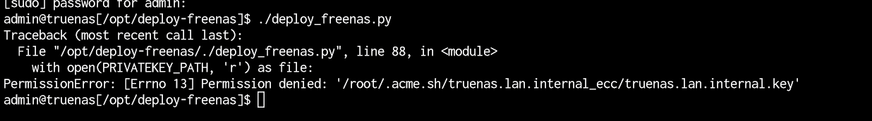

Where do I find the truenas.lan.internal.key? Is this identical with the file localhost.key generated with smallstep???
As I have no such file I generated and empty file with touch /home/admin/.acme.sh/truenas.lan.internal_ecc/truenas.lan.internal.key
10. Starting deploy_freenas.py
I get the following error message:
admin@truenas[/opt/deploy-freenas]$ ./deploy_freenas.py
File "/usr/lib/python3/dist-packages/urllib3/connection.py", line 169, in _new_conn
conn = connection.create_connection(
File "/usr/lib/python3/dist-packages/urllib3/util/connection.py", line 96, in create_connection
raise err
File "/usr/lib/python3/dist-packages/urllib3/util/connection.py", line 86, in create_connection
sock.connect(sa)
ConnectionRefusedError: [Errno 111] Connection refused
File "/usr/lib/python3/dist-packages/urllib3/connectionpool.py", line 699, in urlopen
httplib_response = self._make_request(
File "/usr/lib/python3/dist-packages/urllib3/connectionpool.py", line 394, in _make_request
conn.request(method, url, **httplib_request_kw)
File "/usr/lib/python3/dist-packages/urllib3/connection.py", line 234, in request
super(HTTPConnection, self).request(method, url, body=body, headers=headers)
File "/usr/lib/python3.9/http/client.py", line 1255, in request
self._send_request(method, url, body, headers, encode_chunked)
File "/usr/lib/python3.9/http/client.py", line 1301, in _send_request
self.endheaders(body, encode_chunked=encode_chunked)
File "/usr/lib/python3.9/http/client.py", line 1250, in endheaders
self._send_output(message_body, encode_chunked=encode_chunked)
File "/usr/lib/python3.9/http/client.py", line 1010, in _send_output
self.send(msg)
File "/usr/lib/python3.9/http/client.py", line 950, in send
self.connect()
File "/usr/lib/python3/dist-packages/urllib3/connection.py", line 200, in connect
conn = self._new_conn()
File "/usr/lib/python3/dist-packages/urllib3/connection.py", line 181, in _new_conn
raise NewConnectionError(
urllib3.exceptions.NewConnectionError: <urllib3.connection.HTTPConnection object at 0x7f9006f5daf0>: Failed to establish a new connection: [Errno 111] Connection refused
File "/usr/lib/python3/dist-packages/requests/adapters.py", line 439, in send
resp = conn.urlopen(
File "/usr/lib/python3/dist-packages/urllib3/connectionpool.py", line 755, in urlopen
retries = retries.increment(
File "/usr/lib/python3/dist-packages/urllib3/util/retry.py", line 574, in increment
raise MaxRetryError(_pool, url, error or ResponseError(cause))
urllib3.exceptions.MaxRetryError: HTTPConnectionPool(host='tinyca.lan.internal', port=80): Max retries exceeded with url: /api/v2.0/certificate/ (Caused by NewConnectionError('<urllib3.connection.HTTPConnection object at 0x7f9006f5daf0>: Failed to establish a new connection: [Errno 111] Connection refused'))
File "/opt/deploy-freenas/./deploy_freenas.py", line 97, in <module>
r = session.post(
File "/usr/lib/python3/dist-packages/requests/sessions.py", line 590, in post
return self.request('POST', url, data=data, json=json, **kwargs)
File "/usr/lib/python3/dist-packages/requests/sessions.py", line 542, in request
resp = self.send(prep, **send_kwargs)
File "/usr/lib/python3/dist-packages/requests/sessions.py", line 655, in send
r = adapter.send(request, **kwargs)
File "/usr/lib/python3/dist-packages/requests/adapters.py", line 516, in send
raise ConnectionError(e, request=request)
requests.exceptions.ConnectionError: HTTPConnectionPool(host='tinyca.lan.internal', port=80): Max retries exceeded with url: /api/v2.0/certificate/ (Caused by NewConnectionError('<urllib3.connection.HTTPConnection object at 0x7f9006f5daf0>: Failed to establish a new connection: [Errno 111] Connection refused'))

There is no version for truenas. So i use the version for freebsd right?
polaolla
Mar 27, 2024
4
Ok got it truenas core is freebsd and truenas scale is debian. Got the right step.
First command
  • /path/to/step ca bootstrap --ca-url …
Was a sucess: root.crt was copied to .step/certs/root_ca.crt
But next command
  • /path/to/step certificate create ….
Gave error:
—profile leaf requires the —ca flag
